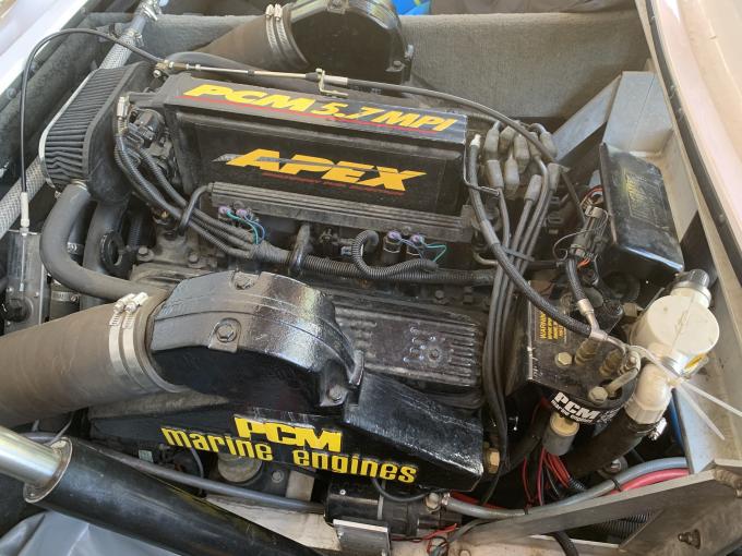

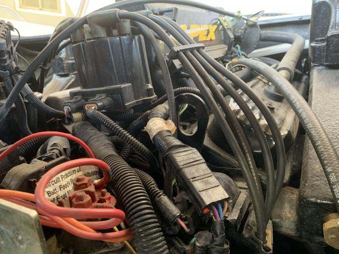

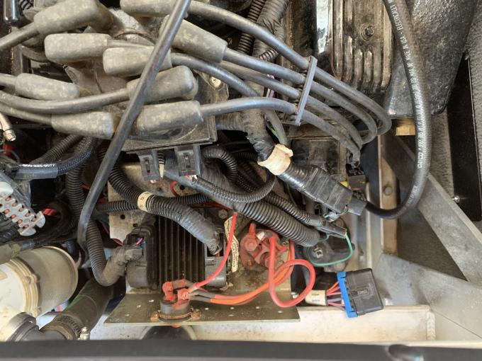

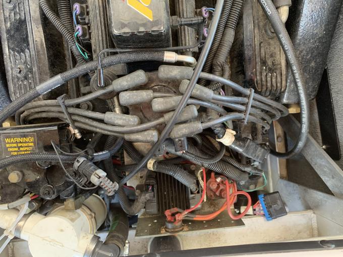

                Some pics. The Fuel Control Cell canister is removed at the moment, don't be thrown off by that.... I took the black plastic cover off (far right side of the first pic) for the other pics.

                    This is completely different than the gt40. I could not find any info on it online.
                    Looks like a gm engine doe anyone know if this was used in a car or truck as well?
                    I also can't make out the actual control module where is it?
                    Sent from my SAMSUNG-SM-G870A using Tapatalk

                        As stated earlier, the check engine light should come on with the ignition before the engine starts as there is no oil pressure. Page MT17 of the PCM book shows the same circuit for the GM engines as a Ford GT40.
                        The 5.7 APEX is a GM 350.
                        This definitely sounds like something other than limp mode for oil press or high temp.
