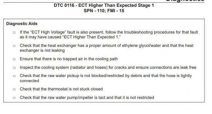

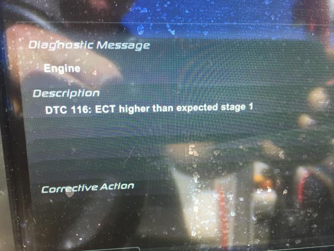

Got this engine code the other day. Probably just some crap on the intake. All other gauges were normal. Haven’t had any issues since.
The code is still on my “Engine Diagnostics” page on the Linc 2.0.
How can I clear the code. I’ve done a search and haven’t been able to find anything specific to clear it. Is it like a car, 11 or so good starts and the code goes away?
Thanks
