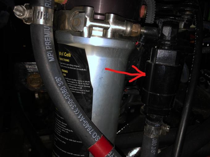

    New to me 06 SV 211 with 330 excalibur. The fuel line to the low pressure fuel pump has a small canister right before entering the pump. Is there a filter in there that I should be replacing or does anyone know what it is?

    The larger silver canister is your FCC. Yes, there is a paper FCC fuel filter in there that needs to be replaced.
    The smaller black piece the arrow points too does not have any filter as far as I know and not sure what it does but believe that year boat also has an inline fuel filter located between the fuel tank and the engine.
    Later years like my boat have the spin on fuel filter/water separator....and the paper filter in the FCC canister. (bottom of your FCC canister should have a plug), you remove to drain the fuel before removing the canister. If any water in fuel, that is also where it collects so I typically drain into a container and let sit so I can see if any water was in my system.

      Thank you, that is very helpful, I know all about the FCC and the paper filter but I checked for an in-line filter last night and so far I don't see one. Going to double check again when I get off the road. I was wondering if the black canister was it.

        The small black canister does indeed have a filter inside. Unscrew the bottom half of the canister and you will find it. Special filter from Nautique.
          So Nautique parts showed me the same thing. It looks more like a screen. Should a guy replace it or do you just pull it off and clean it, or is it even worth pulling apart? Looking for opinions!

            I recommend changing this "pre-filter" each time you change the FCC filter. It can become clogged and restrict fuel flow since it is the first filter that fuel passes through. Or, remove the "pre-filter" canister altogether (delete it) and replace it with the easy-to-change Nautique inline filter mounted in an easy to access location in the fuel hose.

              Learn something new every day, I stand corrected....sorry for the bad info

                  Tried to get the canister loose today with the screen filter. Could not budge it. It would be easy to break off the lp pump to so not sure I just won’t leave it for now.

                              Is there a pre-filter on this era SAN?
                              How difficult is it to removed the small black canister by the FCC? is this screen cleanable?
