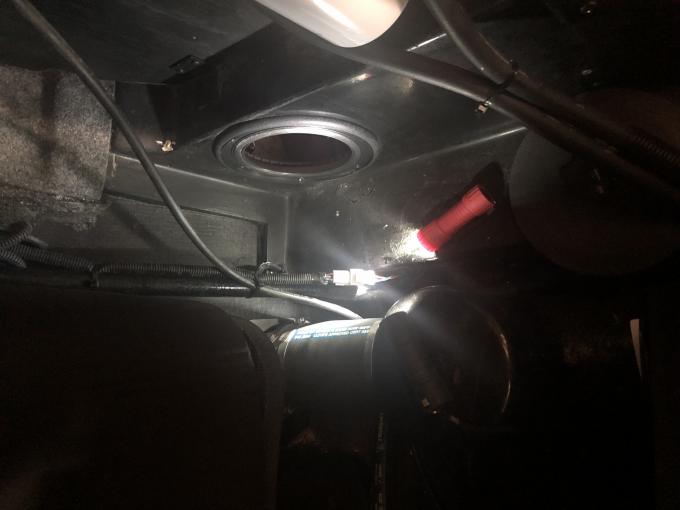

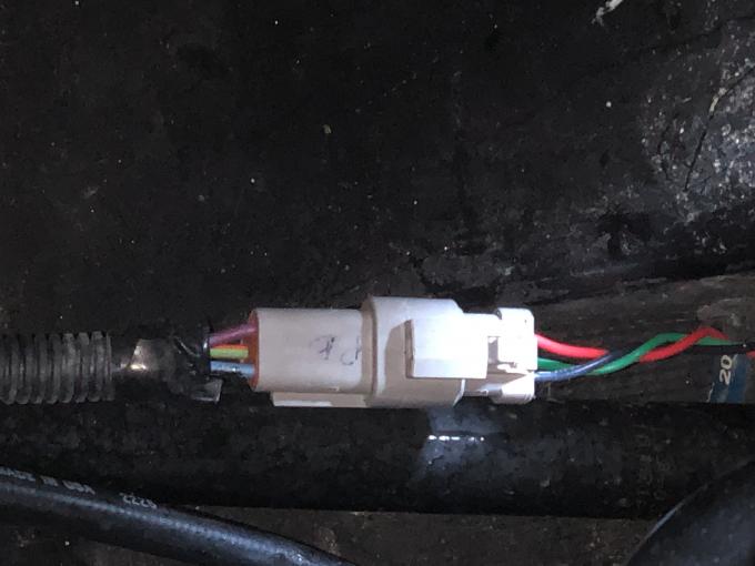

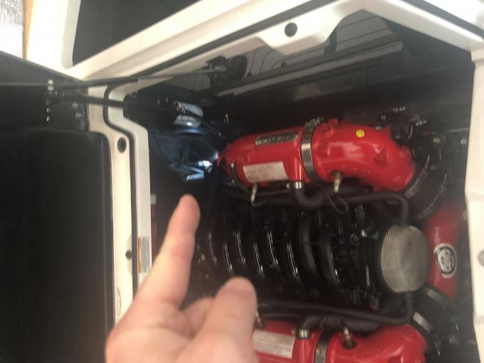

    Mine failed too. I ran across another thread on here that indicated your could unplug it and it would ignore the signal. I'm crossing my fingers as it keeps shutting down the pump when its at 100% but actually empty. I'll know in about an hour if it worked or not. These were taken just before I unplugged the sensor. Mine was reading just over 3V when it was plugged in. Unplugged its reading 4.99V so I'm not optimistic that this will allow me to fill unless the computer knows this value is out of range and will just ignore it.
    Here are some pics where the plug is located:

        Unplugging worked like a champ. I just filled it until I heard water going off the side. I did a complete fill and drain to get the computer set back to zero.
