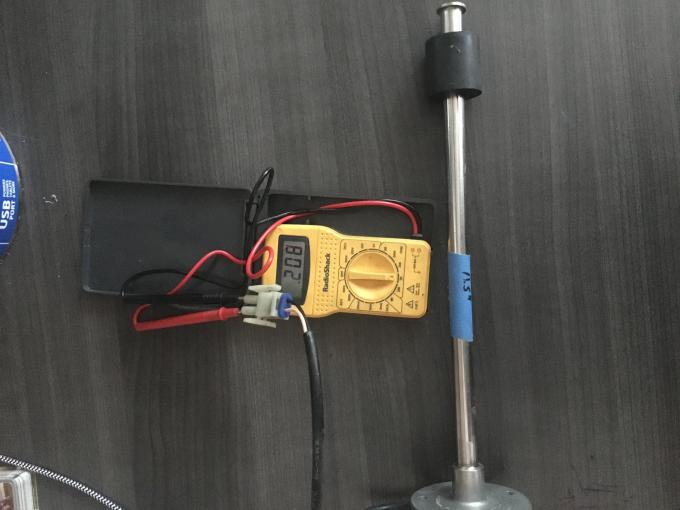

    Your problem is most likely the sending unit or gauge. If the gauge is showing empty the pump won’t come on to empty the tanks. In my case all 3 of my sending units were bad some how the floats lost their magnetism (spelling?). So when I ran a magnet around on the sending units the gauges would react and the pumps would turn on to empty.

      That’s a great tip Shawn. Did you remove the sender from the tank to test this? How big of a magnet was needed?

        I removed one then plugged it in to the other pigtails to test before removing all the sending units. I used a magnet that was on the bottom of my flash light it wasn’t to big. You can also test the sending units with you ohm meter.
