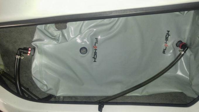

                      First pic is bypassed. Stern is to the left of pic.

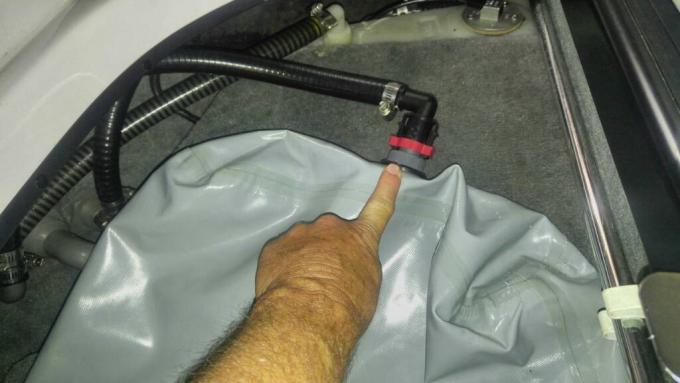

                      Second is ready to fill and drain.

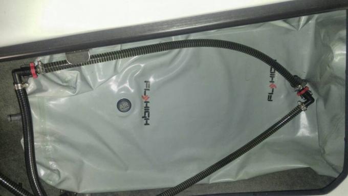

                      Third pic, This port goes to the bow connection on the bag.

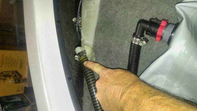

                      Last pic, This port is connected to the stock hose that goes to the overflow port in the hull.

                        Believe it or not, the bags will completely empty.
