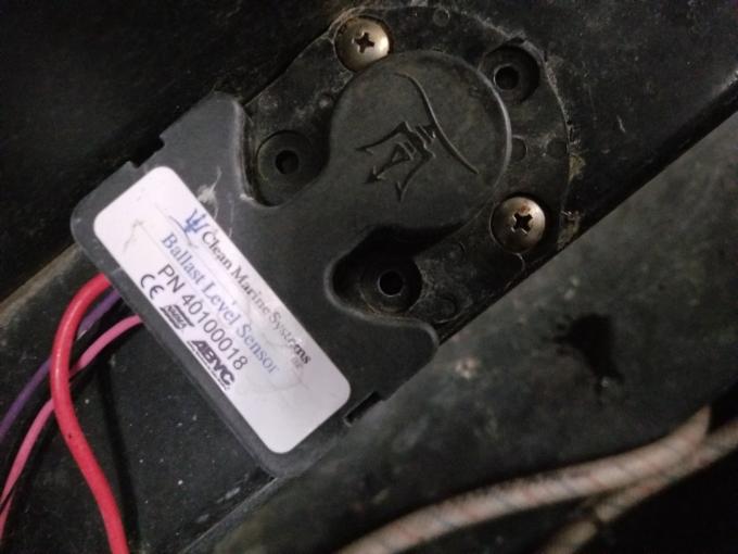

                        Here is a pic of the ballast pressure sensor. My dealer gave me a replacement under warranty. I installed it myself and it was a huge pain to install. It would help to have a couple extra joints in your arm. It is accessed be removing the rear engine divider (the small section behind the slide out divider). There is a round access port and the sensor is pretty deep in there. I took a 15/16” wrench and cut it in half to be able to fit in the tight space.
ID:	604062Click image for larger version
ID:	604060Click image for larger version
ID:	604061Click image for larger version
                          I bought an endoscope so I could see what I was doing, this is a starboard side of a 2016 G23 with a bad sensor. I was able to remove the sensor, however I see a yellow residue on the threads. I was wondering if anybody knows what that residue is and if I need to put it on the threads of the new one?
