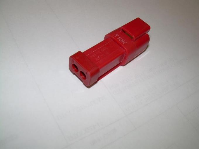

          They replied almost right away and the new sensor is on its way ! They even send me a picture of it, great service all round !

            Can you please post the pic they sent you? It would help many of us identify for future reference.

              I’m glad it worked out, they are good people. And yes i agree with scottb7 please post the picture and part number for future reference.

                The model number is 5507
                Click image for larger version  Name:	7BD11142-68E3-4A61-B6B9-D1B4475F97CE.jpeg Views:	0 Size:	17.7 KB ID:	583620
