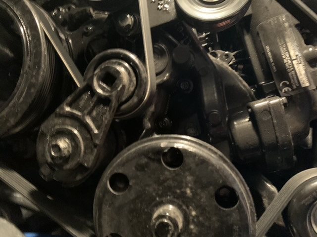

                    *Use belt tensioner to remove the belt. (ratchet w/15mm socket)
                    Click image for larger version  Name:	IMG_8139.jpg Views:	1 Size:	201.4 KB ID:	690369
