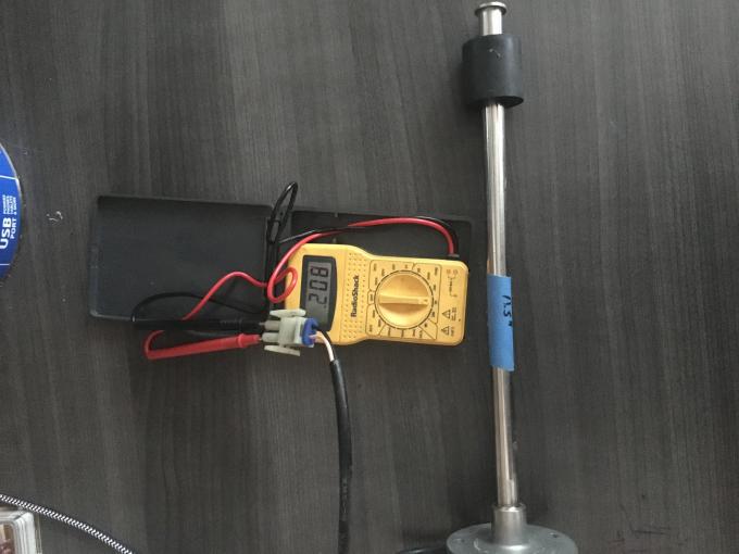

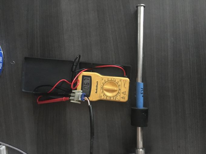

              Im sure you can test them at the gauge but i personally haven't tried. I checked mine right at the sending unit itself by unplugging the sending unit and putting my meter in ohm to test the resistance as the float goes up and down

                You can see here how I tested mine
