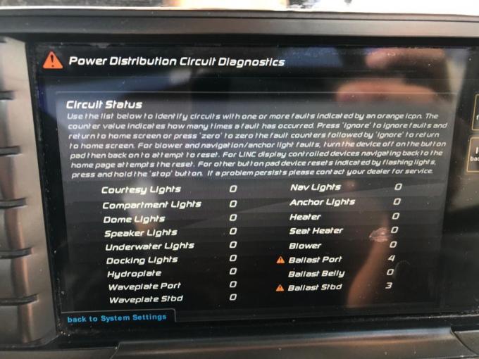

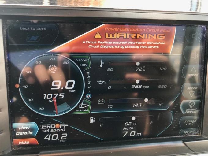

2013 Nautique G23 clear error codes ballast tanks port and starboard
    We need some help on what to try

      Looks to me like the Port and Starboard pumps are drawing too much current and tripping the LINC. Any chance the wrong impellers were installed?

        Check all your wiring connections for corrosion too, could easily be the case in a 2013 even if you always dry out the boat. My 2014 had some corrosion at the speaker connections for the amps recently and I am anal about putting fans on the boat after every outing.

          I had the same error in our 2013 210 and the impeller was just hung. I pulled them all out and made sure they were installed with no bent or hung up blades and it cleared the codes.
