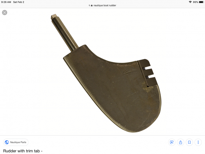

steers hard to the right when under power. Is this normal for a 1999 ski Nautique?
A certain amount of pull one direction or the other is typical. It helps to keep the boat straight in the slalom course with no slop in the steering.
If you don't like it, you can shave the rudder a bit to neutralize it.Please do not PM me directly asking for advice on how to repair your boat. While I would love to help everyone, I simply do not have time to respond to all of the inquiries. Please post your questions on the forum, so that all of our members have a chance to answer.
Probably but further testing needs to be performed before we come to that conclusion.Originally posted by Jan288 View Post
Sounds like the steering cable needs replacing
- Disconnect the steering cable from the tiller arm on the rudder.
- Test the steering. If the steering is still stiff, it's the cable. If it's nice and smooth, the rudder needs to be removed cleaned and re-greased.
-Charles
OK, but again you should TEST as I described above to make sure it's the cable. If it's never been replaced then that's most likely the problem, but you can't say for sure until you've tested it.Originally posted by Tbskis View PostThanks for info. I will try it. Going to replace cable and clean and grease rudder. Easy to steer when going slow gets harder the faster I go. Only to the right is it hard.
Of course you should remove, clean and regrease the rudder because that's inexpensive and fairly easy. Replacing the steering cable is much more involved.
-Charles
