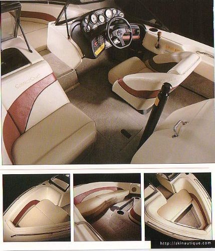

      P.S.2. What is "playpen" ? Tried to google it, but still not sure.
      It’s a 21 foot boat built in the 1990s. You probably won’t get a better wave for the price or for its age. For wakeboarding, it’s phenominal. That’s why the running surface of the hull stayed the same for so long. If you want a great surf wave, you need to buy a more surf-oriented boat. Probably something with a deeper v hull. But you have what you have and it will produce a very surfable wave. It’ll just take a little work.
      You can absolutely put more than 400lbs in the ski locker. I already had a 400lb bag so I’m currently using it. I hear a Fly High 650lb Center locker bag is an almost perfect fit but I haven’t verified that myself yet. I do plan on upgrading the ski locker bag after I’m done with my current ballast install. I just didn’t have the money to get all of it right now.
      A playpen is a flat open bow. You can put bags underneath it but it’s pretty shallow. I’ve attached a pic. I don’t think you have a playpen in a 99. I think it’s a standard open bow seating arrangement.
