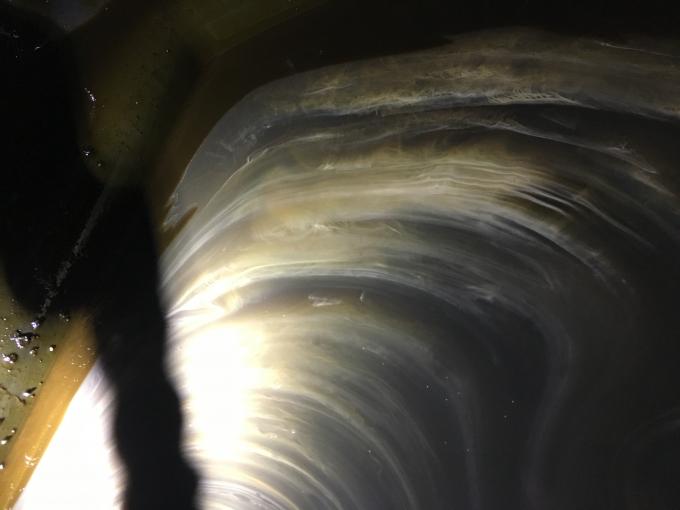

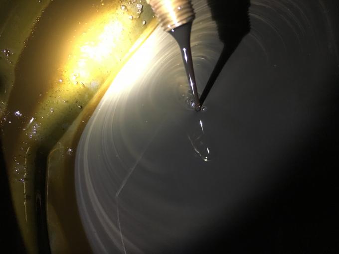

    Today I serviced the boat before hibernation. Before I did, I checked the oil on the dipstick, full, clean and lacking odor. Good. When i pullled the drain hose cap, the oil was laced with a yellow streak indicating, based on my experience, water in the oil. It wasn’t completely milky however it left a significant lace streak while draining. See photos.

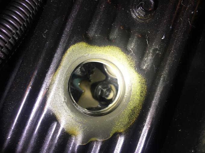

    So, i went up and pulled the oil cap on the valve cover and the little puddles on top of the heads and rockers is milky.
