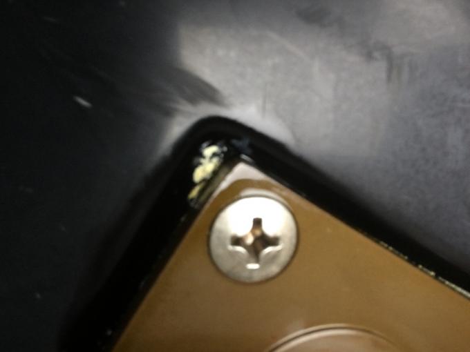

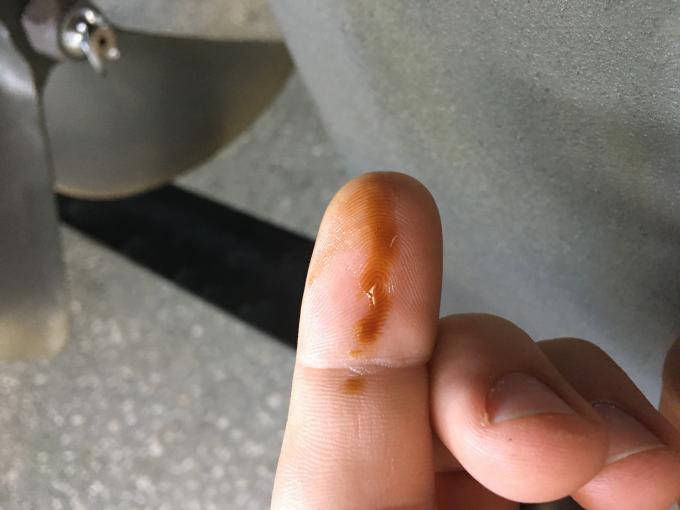

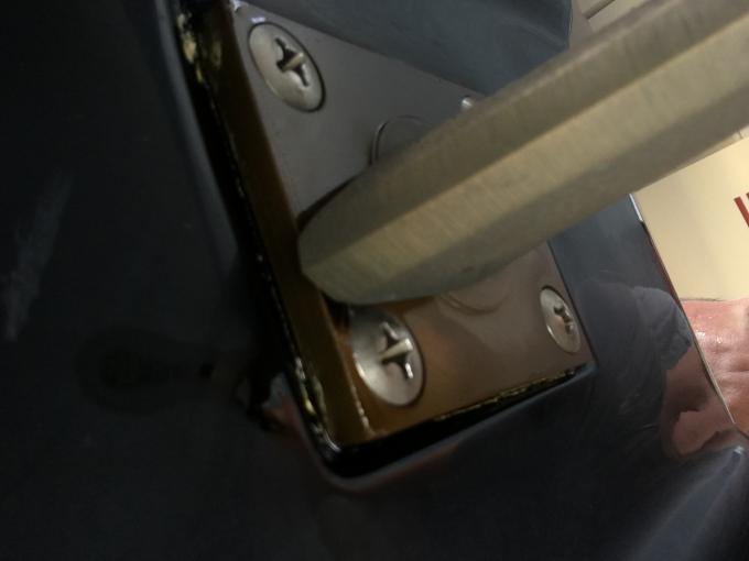

    Noticed a small 2inch oil spot on floor under the boat . Found some oil residue on the rudder plate above the rudder. I’m thinking this isn’t normal . Anyone ever have this issue Click image for larger version

    Doesn’t seem normal, any oil in your bilge?
    2011 SANTE 210 ZR409 (6.0L)
    • ScooterMcgavin
      • 1551
      • 2014 SAN 210 TE
      Check the bilge area under the motor real good with a light could be an oil leak from engine.
      1989 Sport Nautique
      • beamons
        • Jun 2017
        • 379
        • Utah
        You should not have oil coming out of that area. You likely have at least two issues. One the seal around your rudder port is leaky and the other you have some sort of oil leak from your engine or other fluid leak. Like Scooter and McCann said check in your bilge area. Get it clean and then put down paper towels down to see where it might be leaking from.
