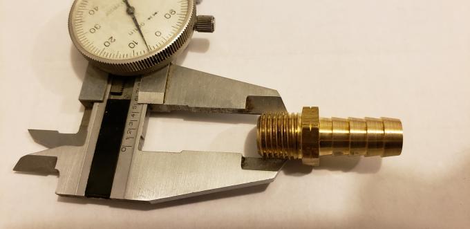

      I use the same brass fittings shown above. But realize you actually need two separate fittings. One is a barbed threaded male brass fitting that you install into the extractor tube. Make sure the barb is the right size for your extractor hose and the threads are the same as the oil drain hose fitting. Then you need the barrel connector to connect the two male-to-male connections you have created (male on extractor tube, male on drain hose). I don't know the size of the threads off the top of my head. But you can measure the fitting on the boat. Mine is about 1/2" external diameter. See the picture below. If you are unsure, buy a few of them around that size and check them for thread fit on the boat before you install the fitting into your extractor hose. Then return the ones that don't work. They are only a few $. The drain hose is at the low point on the oil pan so suction there should remove ALL of the oil (if the engine is level). I pump the extractor another 10 times after most of the oil is out to pull out any sludge in the bottom of the pan. Then disconnect the extractor hose connection, replace the plug, and move on to changing the oil filter.

            I actually took my oil extractor and all hoses to Lowe�s which made it easier to purchase the correct brass fittings
            That makes sense for fitting the extractor inside hose diameter to the correct barb fitting size. But you can cut off 1" of extractor hose for that. My Home Depot had SAE, fine, course, and metric thread fittings. Unless one can remove the oil drain hose from the oil pan it's not clear how you would match the threads to fit that end. I suppose you could drain the oil and remove the oil drain hose cap and match to that?

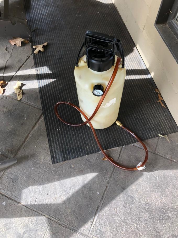

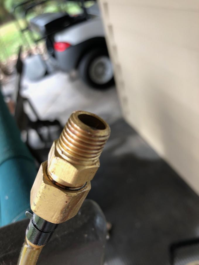

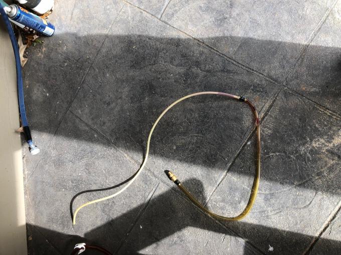

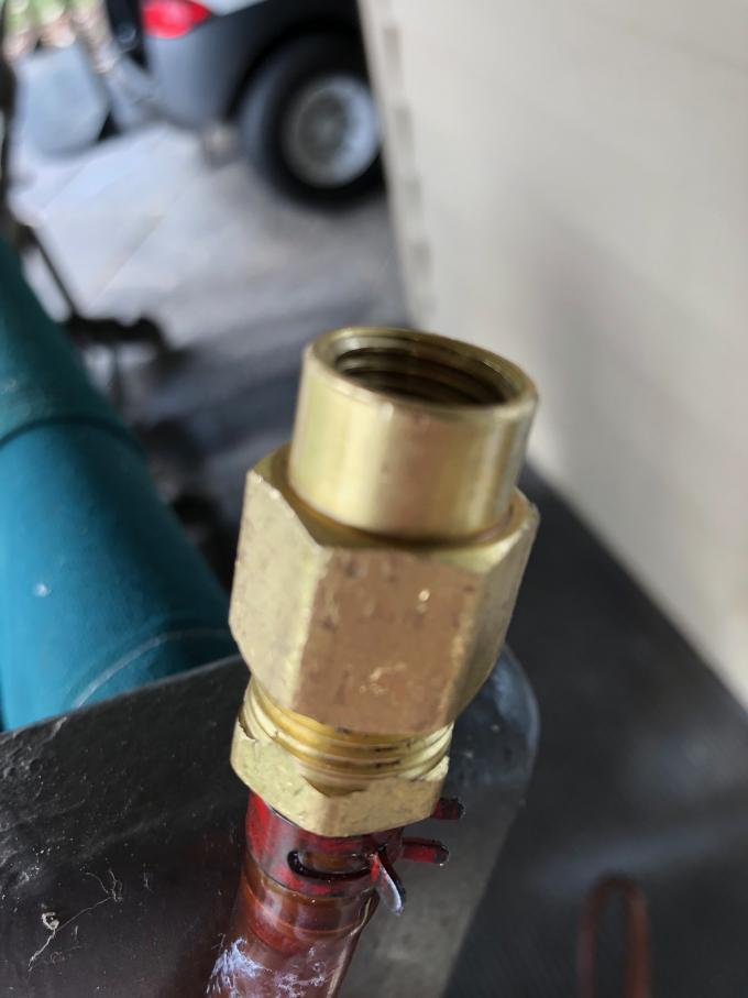

                Click image for larger version  Name:	hard plastic tube attached to rubber hose.jpg Views:	1 Size:	76.3 KB ID:	571861 Click image for larger version  Name:	Motive Oil Extractor.jpg Views:	1 Size:	100.3 KB ID:	571862 Click image for larger version  Name:	Female end on Oil Extractor Tube.jpg Views:	1 Size:	43.4 KB ID:	571863 Click image for larger version  Name:	Male end on end of hard plastic tube.jpg Views:	1 Size:	43.1 KB ID:	571864
                Here is my Oil Extractor set up . I have a Motive branded extractor. Female brass fitting (this fitting directly screws into the Male brass fitting at the end of the oil drain line) attached to oil extractor hose. Male brass fitting attached to optional hard plastic hose which I use for other applications such as my outboard or tractor
