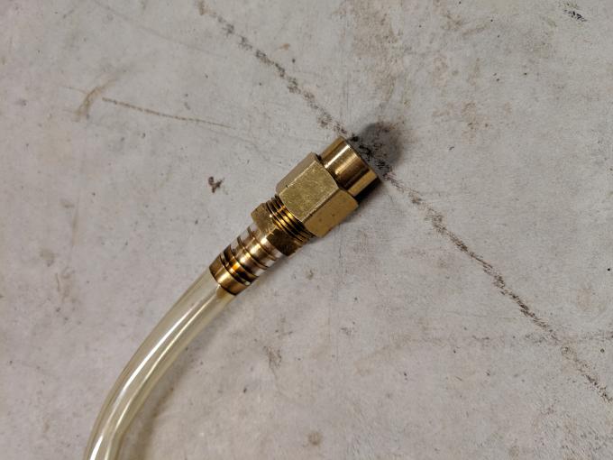

        I use a Mightyvac and changed out the hose so I could add a connection that screws onto the drain hose connection. I found that doing so seemed to work better as it held a vacuum better.

          Yep I have that same brass fitting; works great. I also installed another Male brass fitting on the end of the flexiable tubing which is attached to the ridged plastic tube. I use that tube attachment to suck out my transmission fuild, and my 40 HP Yamaha outboard engine oil

              I don’t know the size of the fitting but the picture of the female fitting Shane posted above is what you want . It screws directly onto the end of the oil pan drain fitting. Also as stated above it helps create a vacuum effect which help the draining tremendously

                I use the same brass fittings shown above. But realize you actually need two separate fittings. One is a barbed threaded male brass fitting that you install into the extractor tube. Make sure the barb is the right size for your extractor hose and the threads are the same as the oil drain hose fitting. Then you need the barrel connector to connect the two male-to-male connections you have created (male on extractor tube, male on drain hose). I don't know the size of the threads off the top of my head. But you can measure the fitting on the boat. Mine is about 1/2" external diameter. See the picture below. If you are unsure, buy a few of them around that size and check them for thread fit on the boat before you install the fitting into your extractor hose. Then return the ones that don't work. They are only a few $. The drain hose is at the low point on the oil pan so suction there should remove ALL of the oil (if the engine is level). I pump the extractor another 10 times after most of the oil is out to pull out any sludge in the bottom of the pan. Then disconnect the extractor hose connection, replace the plug, and move on to changing the oil filter.
