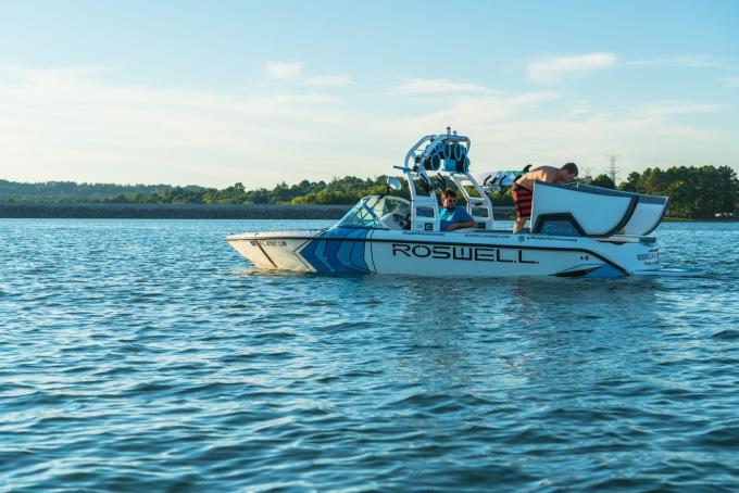

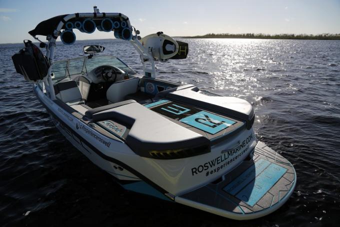

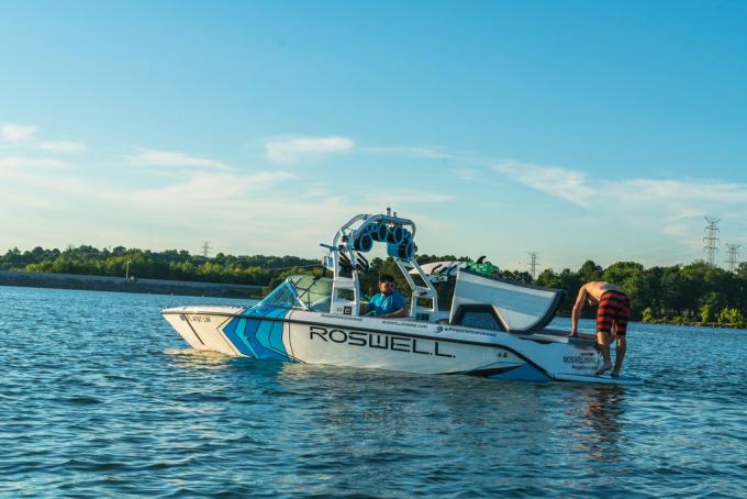

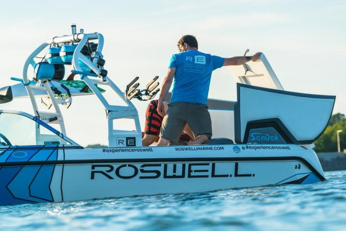

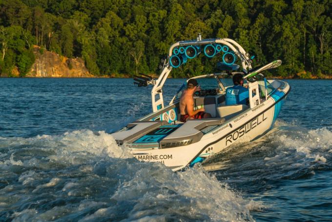

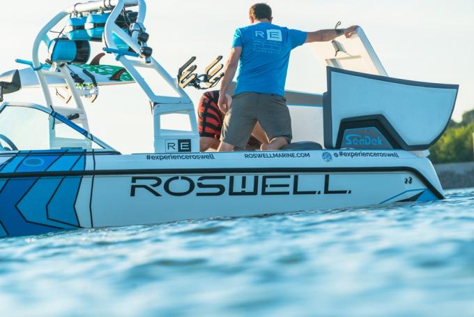

    I would really like to get some details on the steps needed to convert the motor cover to a walk over like in the attached photos. With Roswell and Seadek both being site sponsors, I would think someone could get details on what was done to this 2002 SAN. This conversion looks spectacular.

    I have looked, but never found any build albums for this boat or any of their customs. I am assuming they just tore everything down to nothing and started over. Lots of fiberglass and gelcoat. And of course lots of professionals, I would expect if I tired to do any of this it wouldn't turn out near as well.

        I am still wishing that I could find out more about how to convert the motor cover to a walk over. My vinyl needs replacing and I would rather do something like this rather than just replace the vinyl. Click image for larger version

          I will preface my comments by saying I have not seen the Roswell 210 in person, however, I have seen and been in more than a few OG210's and the "walk through" on the Roswell boat looks like a stock engine cover and hatch covers from a 2001-2006 version boat.
          To my eye, it appears that the "walk through/over" is achieved by removing the stock vinyl and foam from the engine cover (approx. 3"-4" thick) and replacing it with Seadeck which is approximately 1/4"-3/8" thick.
          If you have an older boat with the one piece engine hatch/locker cover this project becomes more difficult, but someone on here has done it.
          Find a good vinyl/upholstery shop locally and show them some pics of this boat and what you want to do with your project.

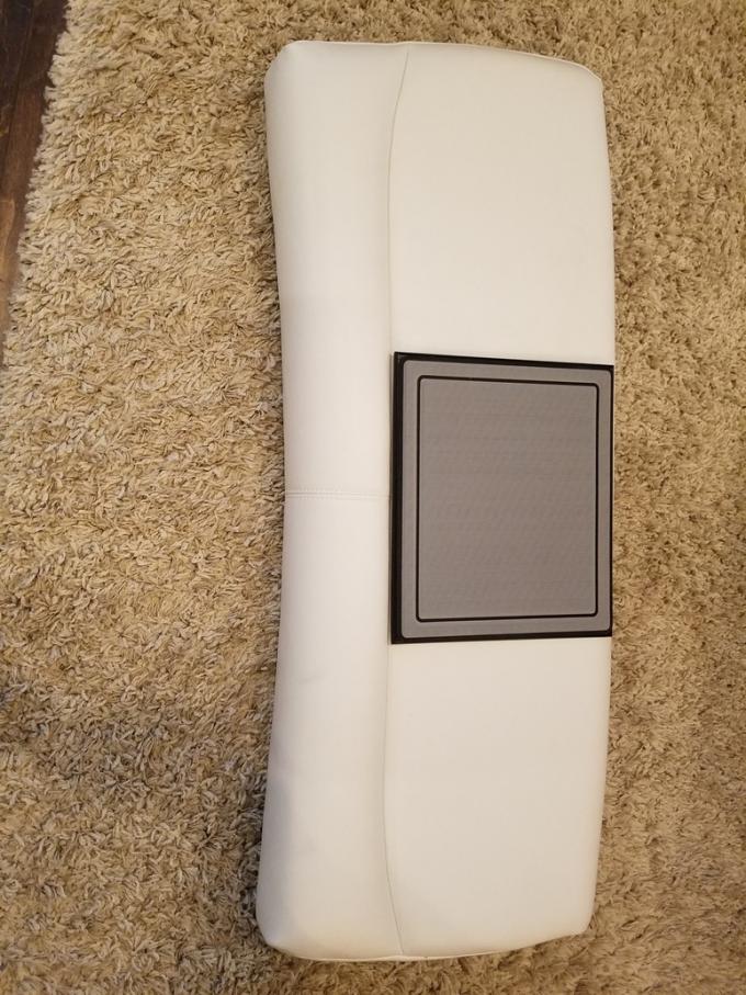

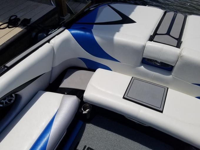

            I was gonna suggest basically the same thing as above, a good upholstery shop should be able to give you a walk-thru by making some modifications to how the foam is cut at the transom and then making sure that the area you will be using as a walk-thru, is re-inforced well enough from underneath. Then template and order Decking. When I had my vinyl redone...even tho I already had a transom walk-thru, I did not want people stepping on my back seat when stepping up to the walk-thru since it pulls the seams loose over time....so I removed the vinyl off my back seat and cut out a 10"x10" section of the foam in the middle of the seat, then filled that area with blocks of HDPE and secured them to the seat so they were solid....then I had new vinyl installed, and then installed a 3/8" thick piece of 12"x12" HDPE directly over the block inserts inside the seat and then covered the HDPE "step" with decking. Turned out exactly like I hoped it would
