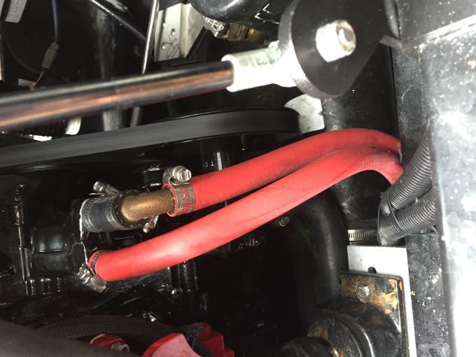

Are these two red lines pictured the heater lines previous threads talk about relative to heater winterizing?
Yes. Disconnect both, and introduce low-pressure compressed air into one of them. I use a standard inflator pump with a cone-shaped nozzle. Push air into one and water will come out of the other. Keep going until all of the water is out.Please do not PM me directly asking for advice on how to repair your boat. While I would love to help everyone, I simply do not have time to respond to all of the inquiries. Please post your questions on the forum, so that all of our members have a chance to answer.
I disconnect and just use my mouth and lungs to push air in and water out. Doesn’t take very long.
Or you can draw it out with a Shop Vac. This isn't rocket science. Just get the water out and you're done.Originally posted by homer12 View PostI disconnect and just use my mouth and lungs to push air in and water out. Doesn’t take very long.
anything wrong with just filing one hose with antifreeze until it comes out just as pink out of the other? That's how I did mine, it was pretty simple
