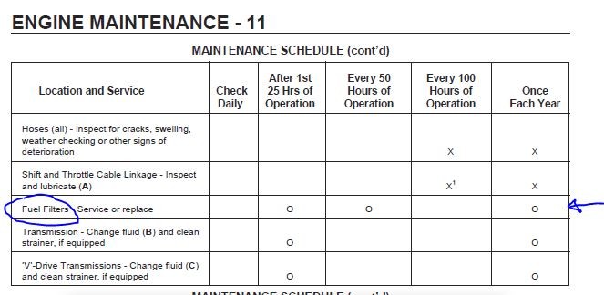

        Charles, can you post pic of what manual says every 200? Cause below from my manual shows "filters", plural and is as post above describes. Once a year or 50.

          The service manager at WLM tells me:
          - Fuel/Water separator filter every 50 hours
          - FCC Filter every 200 hours
          I've done this for 20 years now across two different boats. The results speak for themselves. I don't know anybody that changes the FCC filter every 50 hours. It's a PITA to change and with the fuel-water separator in front of it, you're highly unlikely to see any debris in the FCC canister anyway.

              So when you say "Fuel/Water separator filter" do you mean the Primary Fuel Pre-Filter#: R077019 (Spin-on type)? This filter (as I previously just described as a Primary Fuel Filter) is just a fuel filter, it's not a water separator.
              Per all the EFI PCM manuals I've reviewed (and I don't claim to have reviewed them all) the only water separation is provided by the Fuel Control Cell (FCC).
              Referring to the Primary Fuel Filter as a water separator is quite confusing to me as I have not seen this set-up, are some of your power plants fitted with after market Fuel Filter/Water Separators like "Racor" or something similar?
              Don't get me wrong I certainly think replacement of the FCC filter element at 50 hour intervals is excessive and I'm not advocating for that. I made the personal decision to move to a interval of 150 hours after multiple inspections. When Charles said "Yep, every 200 hours. This is the interval specified in the engine owner's manual" I was like cool, they fixed that, and wanted to read what it said. However it doesn't appear to be the case, as all the PCM manuals I could find appear to say exactly the same thing that mine says. If someone can reference a PCM manual that contradicts this please do.

                Good grief. OK, let's try this again. There are a lot of factors that go into this.
                First of all, the .pdf manual we're all so focused on is from 2014 and hasn't been updated since them. In addition, it's inconsistent. In one chart they say to replace the "fuel filters" every 50 hours, in another block of text they say yearly or whenever engine performance suffers. Now anyone here that waits for engine performance to suffer as an indication that the fuel filters need to be changed is... well.... I'll just leave it at that.
                There are two filters: Here's the primary: https://www.nautiqueparts.com/produc...s-pcm-r077019/ "Fuel Filter – High Performance PCM – used on 2011 to now Nautiques. This is a high performance fuel/water separating filter – 90gph/10 micron filtration – over 90% efficiency" This is why I call it the "fuel/water separating filter." This is the description right off the NautiqueParts website.
                It distinguishes it from the FCC fuel filter which is this one: https://www.nautiqueparts.com/produc...part-rp080026/.
                I talk to my mechanic and service manager at WLM on a regular basis. They keep me updated with the latest information coming from Nautique and PCM. Over the past 20 years, that message has been consistent. "Oil, oil filter, and primary (fuel/water) filter every 50 hours. FCC filter every 200 hours." This is what I have. If you're still unsure, I'd recommend you contact the service manager at your dealer.

                  I certainly see why you say fuel/water separator filter (learn something every day). Although they must not have much confidence in it's water separating ability as the engineers took the outlet from that filter an went straight to a unit with real water separating capability and a drainable bowl. Then identified that unit (FCC) as being required to (among other things) provide the necessary filtration and water separation ... priceless.
                  So it seems we all agree the suggested FCC fuel filter replacement interval identified in the manual has historically been successfully extended. Per Charles the service manager at WLM has identified that extension at 200 hours. However no one has a PCM document to substantiate that and if your unsure contact your dealer. Good stuff.
