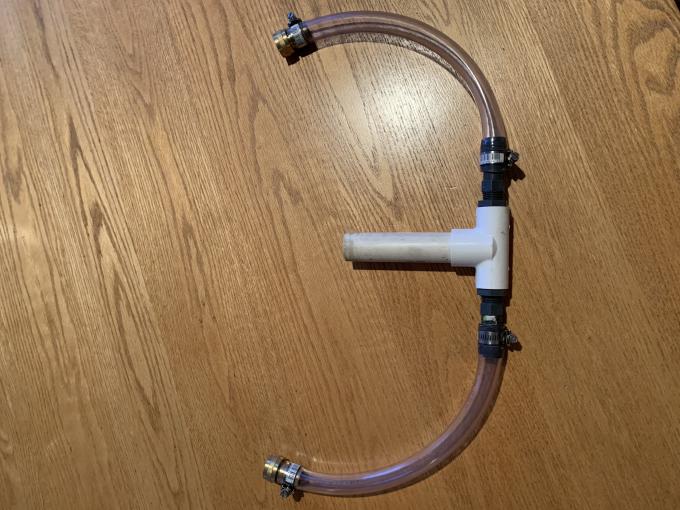

                      I made this out of some pvc, clear hose, and hose fittings. I put the center post in the water inlet before the strainer and hook up 2 garden hoses to unsure that I’m getting plenty of water flow so that I don’t burn out the impeller. Works great
                        2 hoses? Do you have a well with low flow? I've never had a problem with using a single hose, and when I used to do the suck out of the bucket method, the hose could supply faster than the engine could drain the bucket.

                          My well has really good flow but tried the bucket method before but it was sucking water faster than the hose could keep up, so I figured if I just ran 2 hoses it would pump water faster than it was sucking and having extra water running to it never hurt

                            Makes sense if you were pulling faster than your hose could supply.
