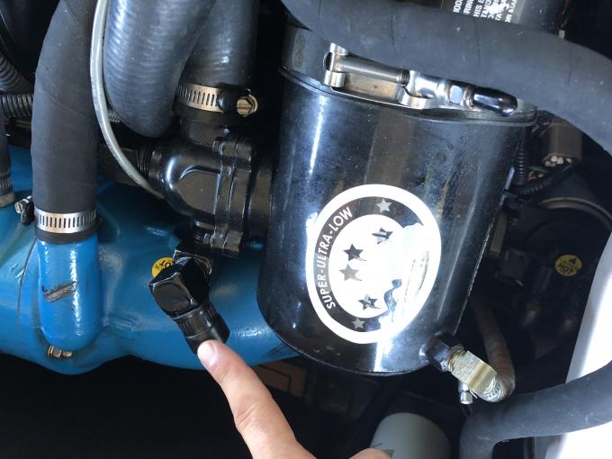

    can anyone confirm if this is the correct place to start the hose from the engine? I took the hose clamp off already, but there is no on/off valve so that is why I was not sure. From here it will run through the recirculation pump to the heater core then back to the connection on the lower port side of the engine. 2014 G23 coastal. Thanks!

        I bet it is in the same location on my H6, and I can check tonight if nobody else knows for sure. That is where I have seen them on other engines.
        Which engine do you have, it often varies? You have closed cooling?

          Yes 450 coastal

            That is the correct spot. I have the same boat, same engine, with a factory heater.

              Dude - any chance you could post a pic?

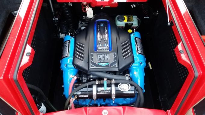

              • thedude
                • Apr 2007
                • 451
                • SW PA

                  Bingo! Thank You.
