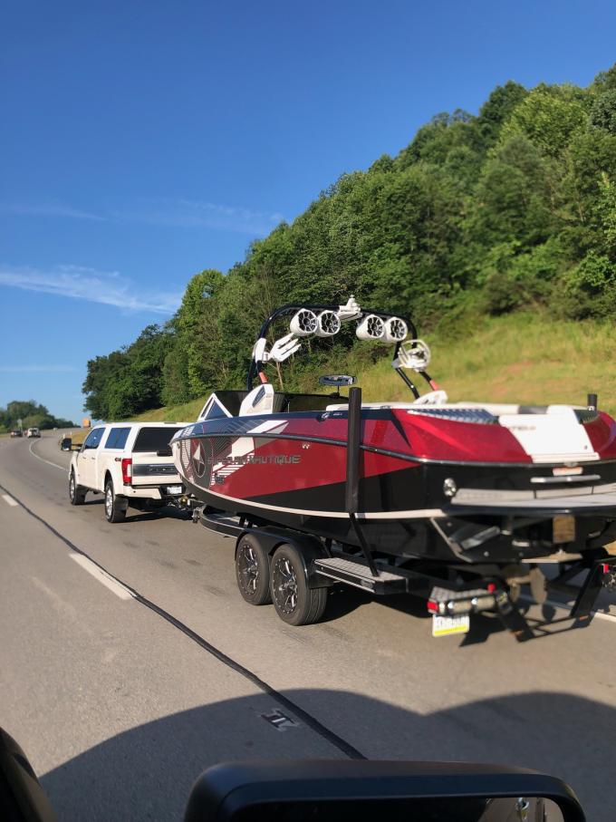

Hey everyone, so have any of you experience fading in your gel coat? I have some real dull spots in my and it’s where my metal flake is. I have tried to wet sand and buff them out but they just won’t budge! I don’t wanna sand too deep! I did sand a decent bit! It makes me wonder if it’s in the medal flake? I bought the boat last October and had these dull spots on it then. It is a 2013 g25. If anyone else had any experience with this and or knows any solutions please let me know it will be greatly appreciated! I will try to get some pictures also
Yeah, post some pictures. There shouldn't;t be any reason it couldn't be wet sanded and buffed back to a good shine. Any chance a repair was done in those areas?Please do not PM me directly asking for advice on how to repair your boat. While I would love to help everyone, I simply do not have time to respond to all of the inquiries. Please post your questions on the forum, so that all of our members have a chance to answer.
If you look under the g25 you can see it pretty bad in the one spot. You can also 2 more spots coming towards the back of the boat. The first pic I posted is on the opposite side and there is another spot or two on that side. Which none of these will come out?
I have a 13 G25 identical to yours. I also have a few spots like you describe. Not as bad as yours but I notice them. I have not wetsanded them. Have had the boat buffed and waxed. They seem to be better after that but come back over time
