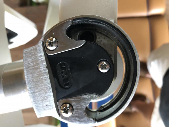

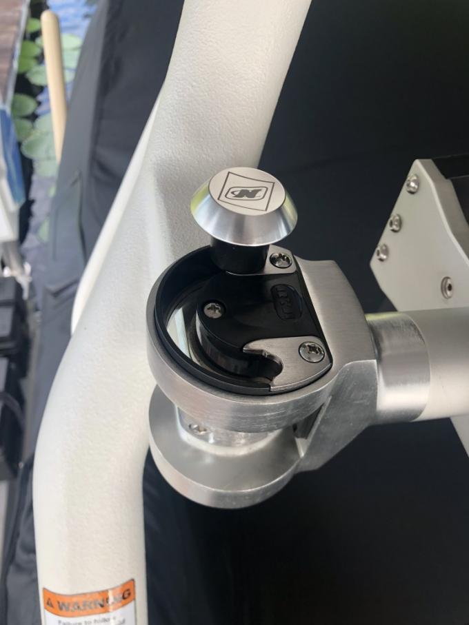

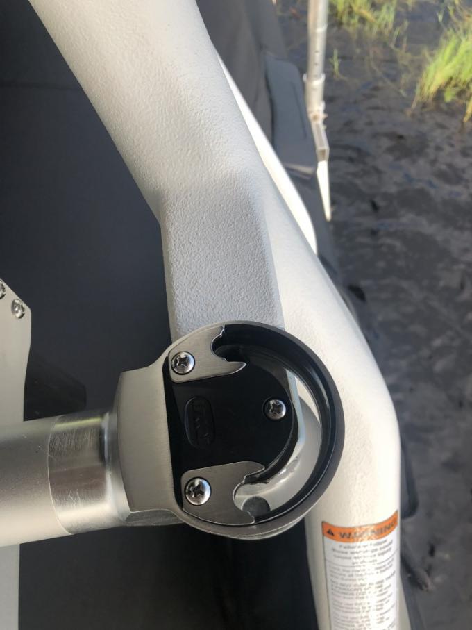

    Anyone with the vertical racks have the know fall offf? I was pulling the racks in for the night and the knob just pops off in my hand and falls in the lake. I sent the pics to my dealer who hasnt heard back from Nautique yet. I wondered if its removable or something broke off inside. I need to try and rig something up for the weekend. Click image for larger version

      The whole rack just spins back and forth, doesnt seem like there is a spring it it anymore, do you know if they just unscrew? maybe I could go get a small bolt to use for now?

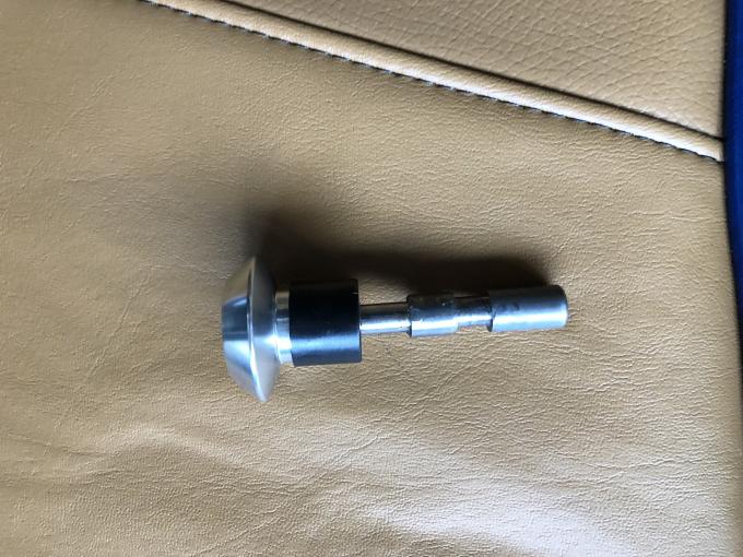

        Yep happened to me. but I still have the knob. How does this happen? If there is any force on the vertical rack such as pulling into your boat house and hitting a piling or hitting the edge of your garage it puts pressure on these knobs wearing down the routed metal edge of the knob pin causing it ultimately to pull completely out of the swivel. I'm going to claim mine as a warranty item and I hope they cover it because a replacement swivel is +/- $200.00

Name:	Starboard Mag Swivel Pin.jpg
ID:	567791 Click image for larger version
Name:	Starboard Mag Swivel.jpg
          Bottlefedsi : Hard to tell from my pin picture but if you notice the bottom edge of the routed pin has worn causing it to come out of the swivel . Same issue you are dealing with. Maybe the long term solution to this problem is that Roswell/Nautique needs to use a stronger type of metal to manufacture these pins vs the current "soft monkey metal"? LOL.

                That is a good point and you are correct. In all these situations, the pin routed metal edging starts to wear down by some type of force whether it is the rack hitting something, forcing the rack to another postion without the pin in the full up right postion, etc. None the less once the metal pin edges have worn down enough the pin and swivel are "Cooked and Done" with replacement as your only solution.
