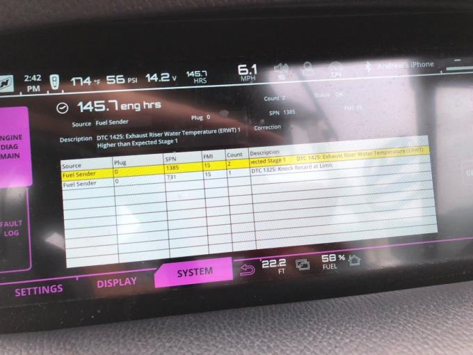

    Today the engine cut out twice after a tight turn at the same spot during wakeboaridng, full ballast and passengers. Going quite fast for the pro riders.
    DTC 1425
    DTC 1325

    Another guy and I have had this happen a number of times to us. Make sure your strainer is clean. If that's clear, it may be an sensor or thermostat in the exhaust manifold.

      I had the knock retard at limit warning as well when wakeboarding once. Shut down and restarted and never came back. I was attributing it to a bad tank of gas. I also have a 2017 G23 with the H6.

        I had the same as thejean describes, except while surfing, on the same year/engine boat. It was indeed a bad tank and went away once we filled up again. I suspect the bad tank was caused by me adding gas from a new place with my usual place’s gas at less than half a tank.

          Thinking could it be it drawn some air in the system while turning since both time are at the same location after the turn.

            Ask your dealer to look into the wiring harness bulletin or recall. Mine had similar code sources and a dealer in Havasu replaced my wiring harness.
