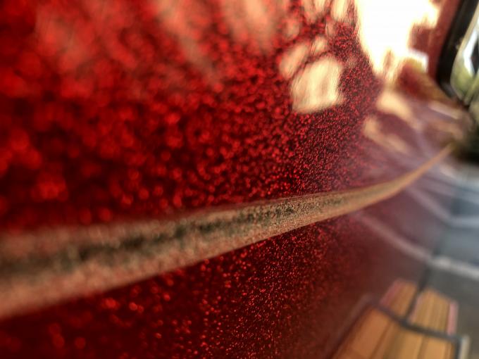

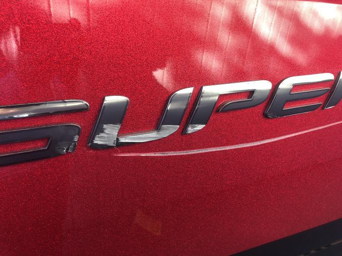

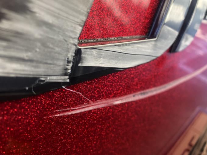

    I am killing myself because I was backing up next to the dock and when reaching for the dock, I nudged the reverse down and sped up the boat along the dock, gouging. 1.5 foot section under the S in the Super lettering on the boat. The gouge runs along the red metal flake and a little deep and about half a pinky in width. The red still shows under the gouge. So how expensive was that mistake? Know any good repair folks in the Seattle area? I want to kill myself now.

        Here are some pics...Not sure if you can tell how deep the gouge is

            Yea, looks kindof deep. Guessing that will need some filler and pro work since usually with new gel-coat filler they actually make the gouge a bit bigger so it sticks right and then redo it. With bright red flake like that....it will have to be done perfectly.
            Google gelcoat flake repair so you know the process. I think he is right.....500-1000 depending on who you use.

                    The flake is actually pretty easy to match color wise, the issue most guys have is the Clear layer clouding up..... So there tends to be a haze where the repair is... It would be worth a long drive if you KNOW of a very good gel guy, I know in my neck of the woods these are very few and far between....
                    Sorry but that's not coming out via wetsand/polish.
