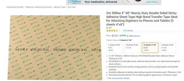

                  I got a double sided sheet of 3M PSA adhesive to fix some seadek I had loose and works great.
                    Yep, me too. Worked perfect. Simply has to be clean and dry.
                    https://www.amazon.com/gp/product/B0...?ie=UTF8&psc=1
