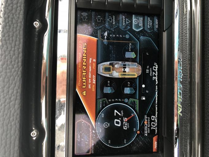

    The following diagnostic message warning showed up on my 2014 G23: DTC 134: EGO1 open / lazy SPN 3217 FMI 5.
    Any idea on what the issue is?

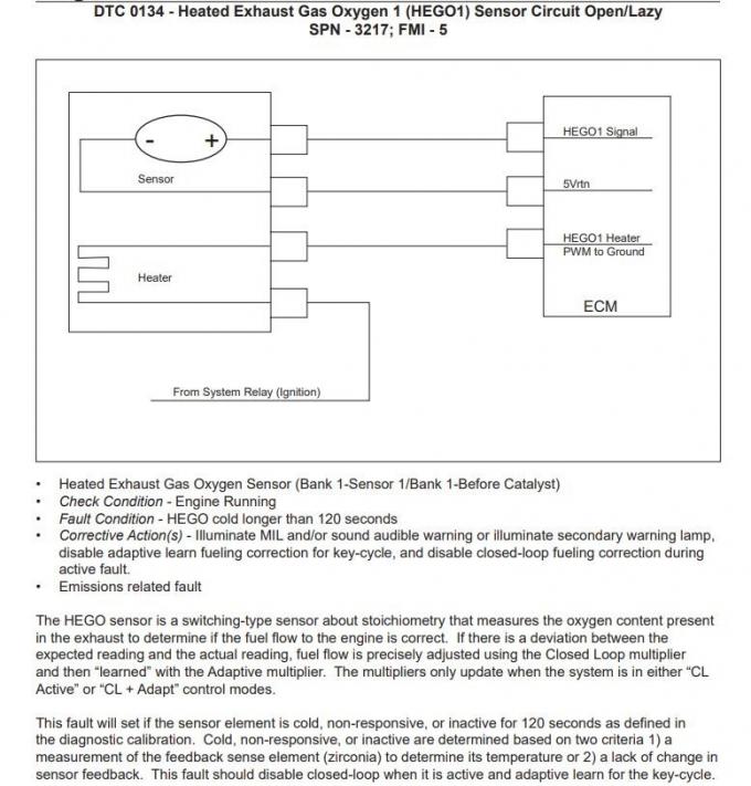

      This code is definitely over my head, but here is the explanation.
      2012 SANTE 230
