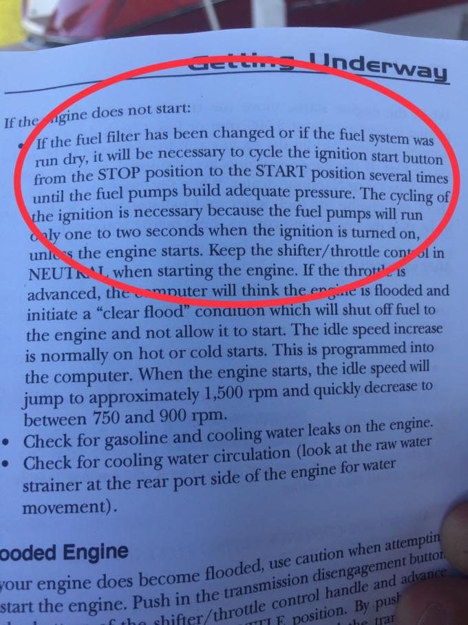

So I just purchased a new to me 2016 G23. We’ve had it maybe 3 weeks...due to be being busy, we’ve only had it out 3-4 times.
Each time out, it’s cut off randomly. No real rhyme or reason. Each time it’s happened, I’ve turned the main battery switch to off...waited 3-5 minutes...and it fired back up.
Today it happened 4-5 times in a span of 2-3 hours. The boat turns over, but never fires. I looked through my manual and when I cycle from stop to start 3-4 times like it says to do...then crank...it fires up.
Thoughts on what it might be? I have a Wake the World event this week and I’d love to get it sorted if anyone has any suggestions.
