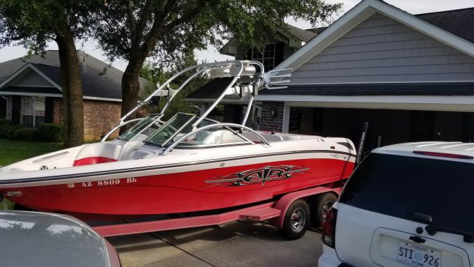

    Just bought a 2006 SV211 Team Edition and noticed that the tower was a bit shaky. After trying to tighten the Phillips head bolts at the 4 connection points on the boat, I noticed some of them just spin without actually tightening. I was able to pull one of the loose bolts out and it was broken. I'm not too sure which tower it is, but I'm curious to know if this is as simple as replacing the bolts, or is the as back-plate located inside of the sides where the tower connects to the boat that will be needing to be replaced. Can someone help explain what options i have.

    What does it look like from underneath? You should be able to see it in the front port side and upload a picture.

      I literally just took one of the speakers out and there is a back plate that holds the tower. I wasn't sure of how to access it.

        You should be able to just replace the bolts with similar Stainless steel ones.

          I really appreciate it. I guess it was the anticipation of the unknown. But, they're all tightened down now. Most were just loose. Again, I appreciate the responses..

            I just removed a tower and reinstalled a tower on my 2004 SV211. Let me know of any more questions because I've seen ALL the bolt locations now . Also, I'd make sure you have stainless nylock nuts on there to keep from loosening again.
