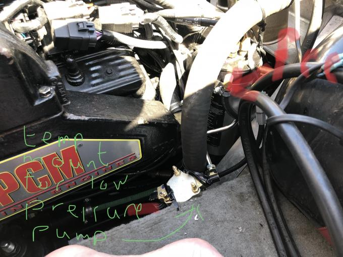

    Ok, a bit of an attention seeking headline, but I’m hoping some of you with a super air 210 may be able to help me out. I’m in Ireland so I’ve had to make repairs using my local car mechanic. We just replaced the high pressure fuel pump (inside the fuel control cell) and the low pressure pump which feeds the fuel into the fcc but because we didn’t have the old low pressure fuel pump (it had been running on propane so the pressurised propane didn’t need fuel pumps) we couldn’t find where to mount the low pressure fuel pump to the engine. The pcm manual only has a few drawings and they don’t show where to mount the pump so I was hoping some of you could post photos of where the pump sits on your boat??
    All help gratefully received. The pump has three mounting screws on the top of it so I’m expecting there to be horizontal plate somewhere with three holes but I’ve looked everywhere and can’t find anything.
    You’ll see in my picture that we’ve had to make do with a workaround......you can see I need a fix for this soon!!!
