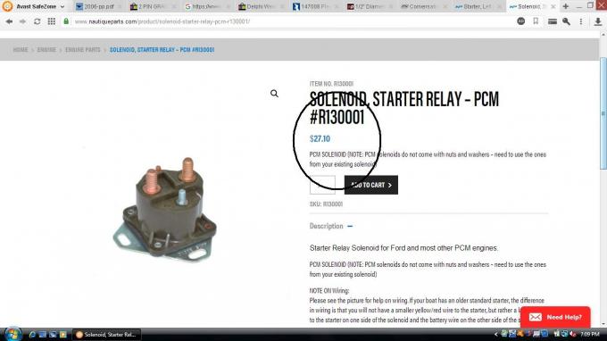

                  I did not say that Charles,those are your words. What I said was that starter is not an oem PCM starter. Maybe thats all Townsend can get since Ford is not supporting Windsor marine engines. There are other options for starters,the one I suggested is built in the USA.
                  Here is an example of a PCM oem part from their site- clearly marked in the text as a PCM part and with PCM part number
                  Click image for larger version  Name:	PCM solenoid.jpg Views:	1 Size:	31.8 KB ID:	559717

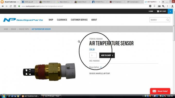

                  Here now is the starter not marked as a PCM part and not a PCM part number nor is manufacturer noted
                  Click image for larger version  Name:	non PCM starter.jpg Views:	1 Size:	29.3 KB ID:	559718
                  Here is another example of a PCM part still available to them from Ford since its also used in a million automotive applications -
                  notice the PCM part number
