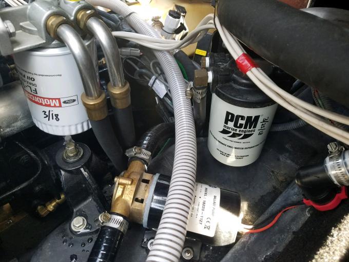

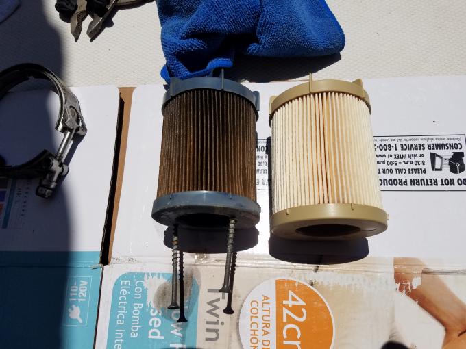

    2 pics below....the first is the FCC filter (After 80 hours and 1 season of running non-ethenol fuel).
    2nd pic...shows the spin on fuel filter (the one on right side).

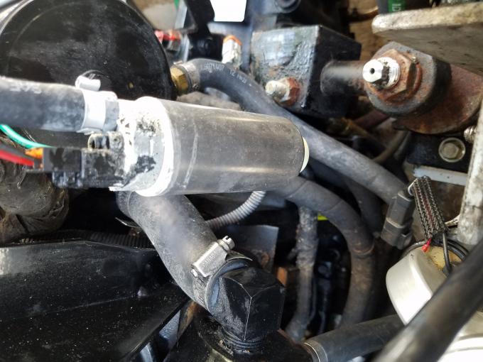

              Here are some photos from the weekend. The FCC filter was stuck and I had to drive long coarse thread screws in so I could grip it with pliers. I also provided a photo of the high pressure pump for the "it should not look like this" library. Also included is a photo of the primary filter. Who knows how old it is... Unfortunately, there was some debris in the fuel system.
              When the fuel system is primed does it automatically bleed the air, or do you have to run it to get the air out?
              Thanks for the tips on the belt...will definitely be a two man job.
              In the pump photo you can get an idea of the work that will be required to clean up the engine compartment. It will require many man hours with de-greaser, a wire brush and paint.

                      FCC filter looked decent, but some debris for sure. would make sense too since it ran out of fuel a few weekends ago. inline filter i'm waiting on the stealership to get today. old one was not in its designated holder, had slipped out aft.

                        To the OP, with that rust on your motor mounts and some corrosion on the engine, it looks like that boat was run in salt water. Do you know the history? My 2004 motor mounts don't look like that.

                            homer12 - Sorry for the late reply, yes...the boat has been run in saltwater. Likely not rinsed after use prior to me buying it. However, the aft mounts have more rust that the fore mounts. Also, I noticed that the drain ports do not have hoses and dump water right on the engine mounts. I need to add hoses.
