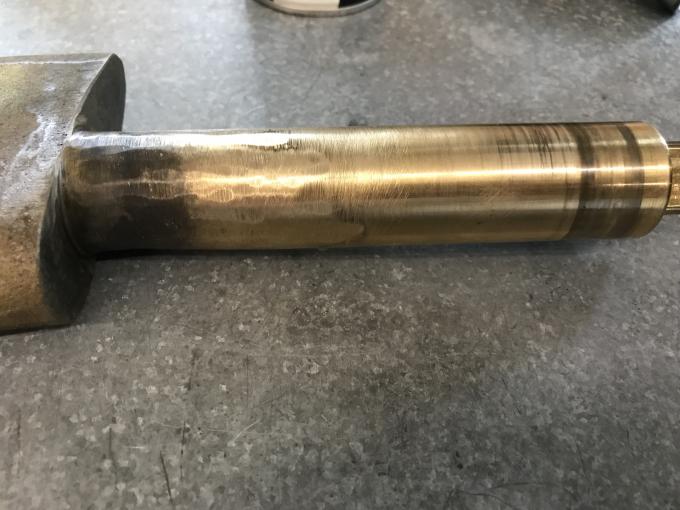

                Wanted to follow up and again thank everyone for their help. If you zoom in below you will see where the problems lies. Charles was correct that a previous owner hit something and either bent or cracked the rudder shaft. You can see that the shaft has been worked on and ground on with a grinder and in no way is the correct diameter towards the lower end of the shaft. Unfortunately I'm a $1000.00 bucks fixing this myself which hurts when you don't expect it. The good news I didn't see any structural damage to the hull. Should be up and running by this Friday. Also I used 3M 5200 sealant. I installed the new rudder port tonight and really want to use the boat Saturday morning. Directions say 48 hour set up time and 72 hours cure time. You think I'll be ok to run this weekend? Thanks

                  Yep. Get everything back in and you should be good to go. Ugh... that grinding job on the rudder shaft makes my skin crawl.
