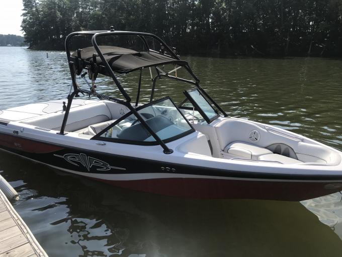

I could be wrong on this, as I've only had my boat for about a year. But I don't believe the separate oil cooler has anything to do with the v-drive. That cools the transmission. So, if your v-drive is making a milkshake, it's likely something internal to the v-drive. You can see in my picture below (assuming it works) where the large water hoses come and go from the v-drive. The transmission is behind that, and uses the same kind of cooler that's been used forever on inboards like this.
