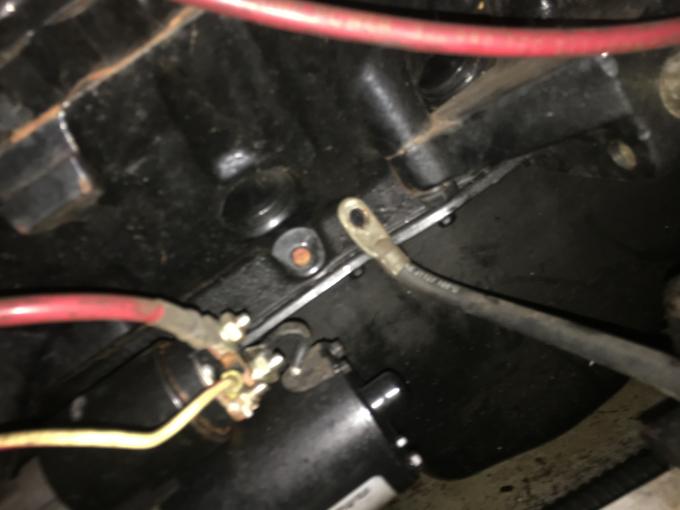

    So on the lake this past weekend and had a couple issues. My SAN would do fine hitting wakes as long as i was below 4K rpm. When i went any faster it would do fine til i hit a wake then entire boat shuts off. I have to put my code back in to start it back up. I checked my battery cables and they are tight. I found another ground on the opposite side of the motor as the battery that looks like the bolt fell out. Could this be my problem? Also my radio kept doing same thing. Even at low speeds. If i was moving it would cut off. I have checked all the cables on the back of it looks and feels fine. Any help is much appreciated. I’m sure there are prob other posts on here but i am new to the site and figured another couldn’t hurt lol

    safe to say you should re-ground that wire and try again....

      Check your master kill switch. The one by your right knee. It might have a loose connection on the back.

        If not the above, maybe a loose plate inside the battery?
