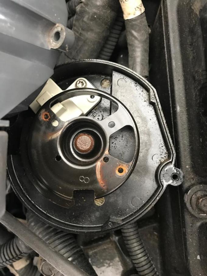

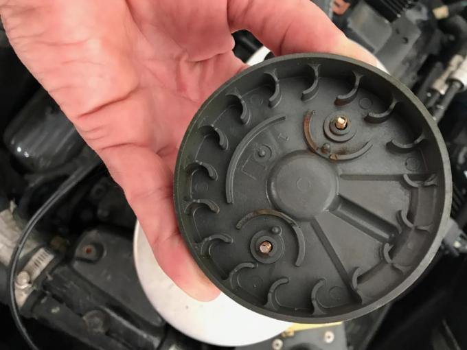

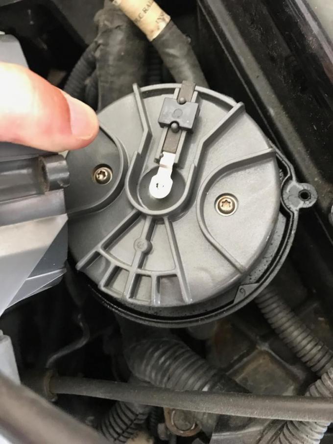

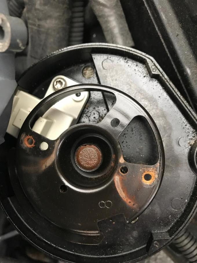

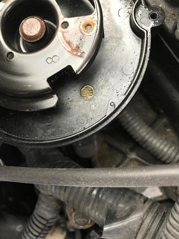

            Dis Cap Pics

                    Your 1st picture is of the rotor,the second picture,the cap is what you are holding to the side in your hand. Replace both. Known problem with Chevy engines

                      ^^ Exactly this. The distributor cap is the part in your left hand. Look inside of that at the metal contact points, if they aren't clean, it's a sign you should replace the cap and the part below that (the rotor). This is an easy place to start.
                      If you do it yourself, take care in replacing the wires in the exact same order, of course. You can transfer them one at a time, just line up the new cap and old one side by side.
                      Then this business about a sensor getting wet from a leaking pump... let's see if the boat runs well with a new cap & rotor first.

                              What does the connections on the bottom of the cap look like, where each plug wire point comes in contact with the rotor button? I have a 2003 SAN that does the exact same thing and kept getting corrosion on the terminals. I could clean them off and it would run fine after that. I installed a new cap, but It will still corrode up but not as bad or as often. I still have to clean them off about once a season.
