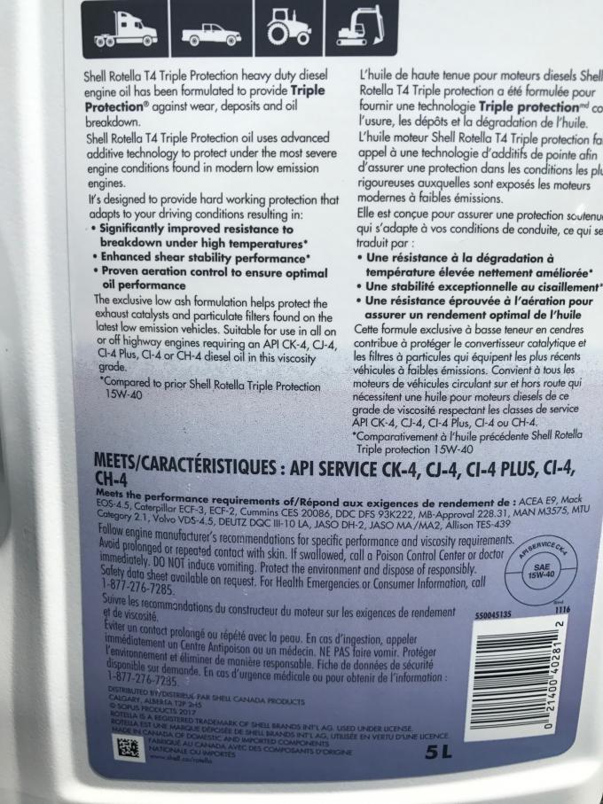

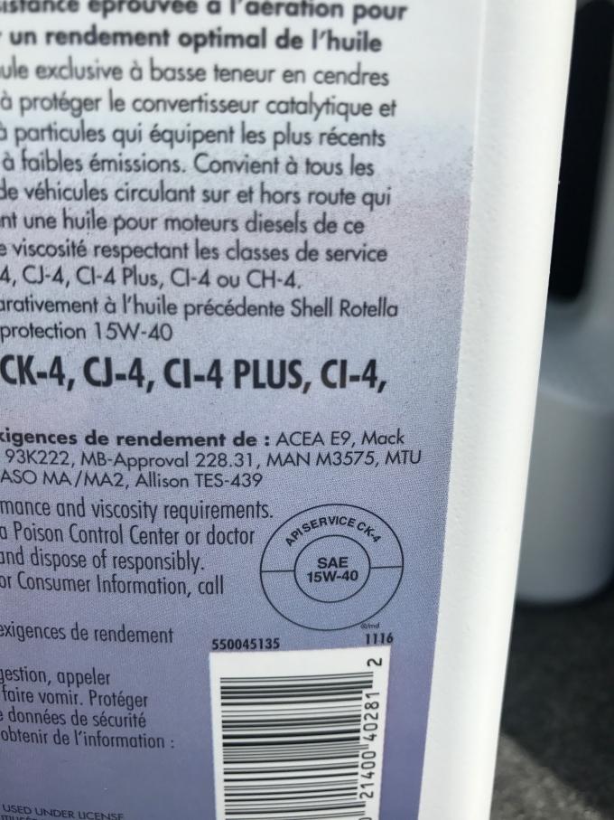

            Hi guys,
            SO I bought the shell rotella oil for my 2008 ZR-6 390hp. The only thing I am worried about is nowhere on the oil container is it listed SM or even SN, which is the newer version, and that was a requirement from the manual (You can see the pics). Can you please let me know if it is still okay to use. Maybe this is backwards compatable.
            210 SANTE

              SM and SN ratings are for gasoline engines. You won't see these ratings on oils branded for diesel engines which is 99.9% of the use for the SAE15W-40 that most everyone here is using in their boats. You can find enough research and reading material on engine oil for a novel, but the biggest key is oil/filter changes every 50 hours and with winterization. More resources if you're interested:

                hi rlwagens, sorry I didn't 100% understand here what you are trying to say. Are you saying it is okay to use this oil in my boat despite that fact that it is only c class and there is no mention whatsoever of s class ?
                  Yes, you're fine. My dealer buys Rotella 15W-40 by the 55 gallon drum. They put it in every boat.
                    Yeah, sorry. I meant to clarify that the ratings don’t really mean much due to the way the oil is branded once it gets to that high a viscosity. Pretty much everyone is using that same oil in their boats. You’ll be fine.
