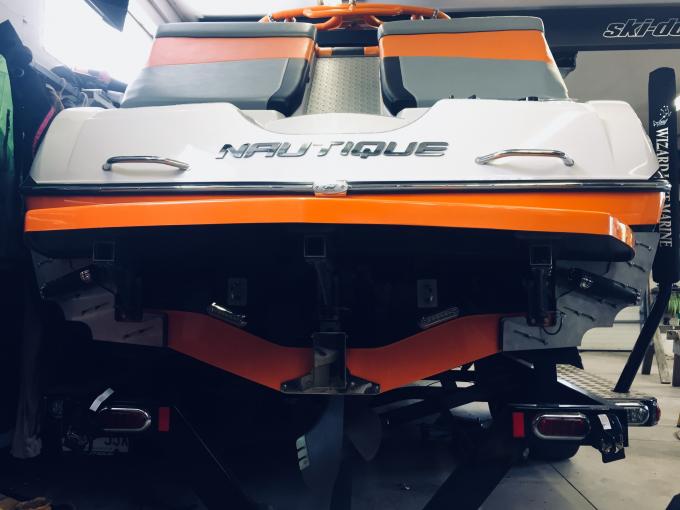

    I’ll let you know soon! I have a 2010 230 and I just installed an aftermarket NSS system on it! I really hope it does work better then my suck Gate. It will for sure be more convenient atleast!
    I run 750s & 650 integrated bow over stock tanks with a suck gate before and it would really only get good with 5+ people in the boat. I was told the NSS will grab better then the smaller suck Gate.... I’m hoping it warms up soon here in Canada to try out my system

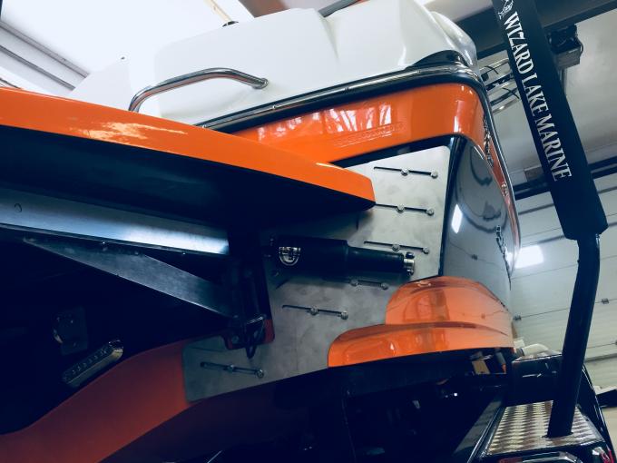

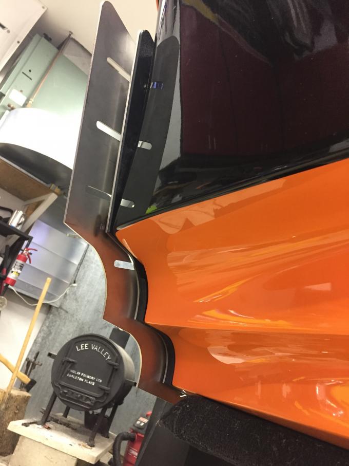

      Install photos

        Anxious to hear your results. I am about to install what I believe is your exact system. I looks nice and clean.

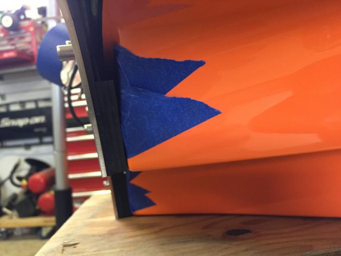

          Give us a side view of your shim please.

            Just prior to drilling holes...

              I can take more pics when I get home from work. I’m assuming you’re concerned about the curve of the boat... I was also and it bolts up real nice and slides easy with the strong lencos

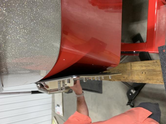

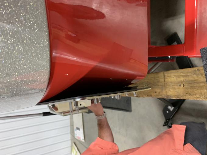

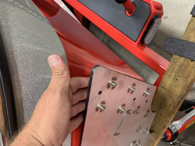

                      I'm about to help a friend install this kit on his 230 but the curves seem pretty extreme. I'm pretty worried about getting the holes exactly right on the curved surface. Any suggestions?
