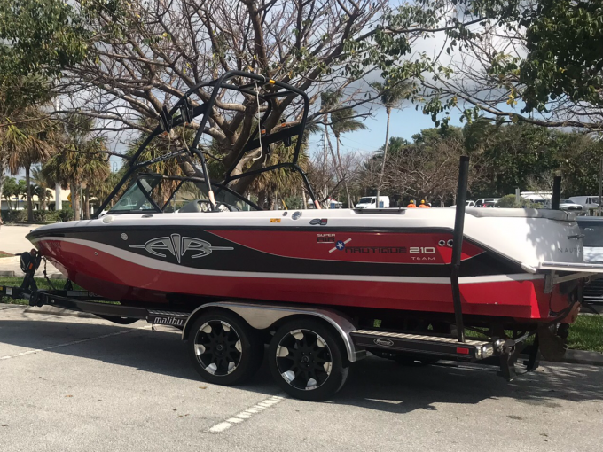

      Here’s a picture of her. Also curious as it seems there might possibly be a different cooling system for salt water boats? Not sure.
      thanks again.

            Love the colors. My 2003 was the inverse of yours.

                  Not 100% sure about this... but the trailer says Malibu. Asking the rest of the members, would the bunk placement cause issues?

                    I will take a picture of the engine when I get back to the boat this weekend. I was also wondering if it had a different system because it doesn't quite look the same as others I have seen. thanks Dgee I will def get back to you. And gome123 I sure hope not as I trailered this boat 600 miles on this trailer. it really looked to be sitting perfect.

                      An 03' would likely be the first Gen Excalibur, you mentioned belts so that means it's V-Belts not a Serpentine which would be 2nd gen. if the Engine shroud is Silver then likely a first Gen. Change cap and rotor for sure, and the other items mentioned would also be a good idea, fluids & filters. If there is a small reservoir with antifreeze and a radiator cap on the motor it is likely closed cooling. Regarding a flush, regardless you will want to run on a hose to check for leaks, etc. which will also flush out any residual salt.
                      Regarding the trailer, you will want to get underneath and ensure no pickups, intakes or your paddle wheel (if equipped) are on a bunk, also see how the hull lands on the bunks throughout, inspect where the bow hits bunks/pads as well. That inspection and how it comes on/off the trailer will help you determine what, if any, mods may be required.

                        yes its a silver cover. no serpentine belt. I just borrowed the trailer as I purchased without one. at the moment I have it which I know everyone will hat eme for but on a standard trailer with raised bunks made out of 6x6. doesn't look pretty but I store the boat about 20 ft from the ramp so its just used to move a few yards. the trailer now is set up like a boat lift so shouldn't be urting anything and there was no contact on the Malibu trailer besides main parts of the hull. I think she should be fine. looking for the right trailer but they are quite pricey. I don't recall a reservoir with cap but is it clearly visible or should I be looking somewhere particularly

                          The trailer you're using sounds like what it would be sitting on in a dry storage rack building. So long as it's not hitting anything important (as has been covered), I'd just put some carpet on them to minimize the scuffs and you're fine.
