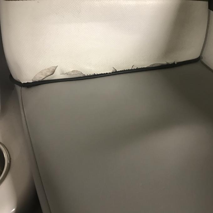

    Not sure if it’s the same issue I have with my ‘07 210 SANTE, but I literally just dropped both my backseats at an upholstery guy this morning. When I bought the boat it had a small tear in one seat and the other side developed the exact same tear a year later. My Nautique shop guys said that they just came out with factory replacement skins which I got and are being put on. It’s that textured vinyl that tore.
    Here are some pics I took for the shop people to look at. Should be a quick job for them. All in all, should be about $600. Ugh.

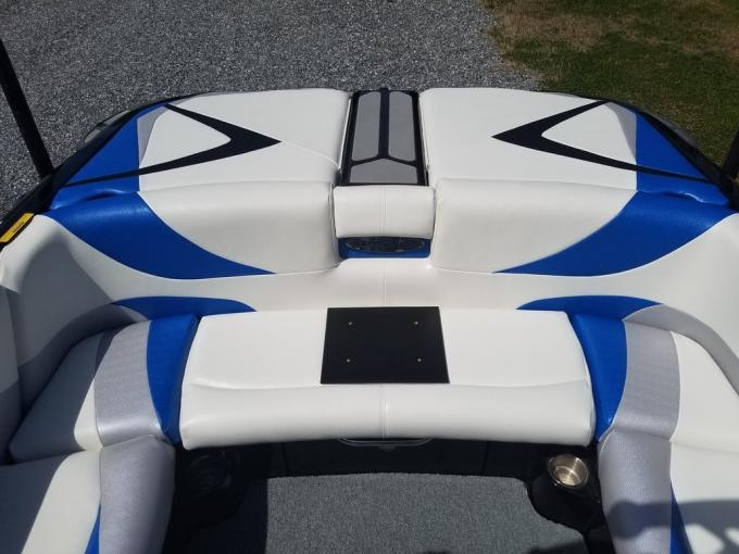

                  It wont look as good, but one way to get more life out of it, is too not have any seams in the vinyl....and do entire seat out of a single piece (least as much as possible), some of the seams are so it will sit right, but I usually see seams tearing, not the actual vinyl....so its a thot.
                  Another thing you could do (this is what I just did to my boat to keep the seams from tearing again) I added a "step" into the back seat so that no one steps on the vinyl of the back seat, that should help preserve it (the new G3 boats have something similar). Mine is 2014 and the seam was starting to come apart cause people step on seat to get up to sundeck walk-thru each time...directly where you step there is a seam and over time its gonna come apart no matter what you do. I removed vinyl....installed a solid insert (using HDPE) into the foam.....then had new skin installed over insert and then installed this black piece of HDPE that you see that will act as a step. I screwed this piece down, thru the vinyl and into the insert below the new vinyl so it sandwiches the new vinyl. (I also have a piece of Aqua Marine decking that will go over this step, to give it a finished look and so it wont be slippery when you step on it.

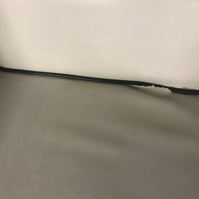

                        This is what happens over time with the L seat
