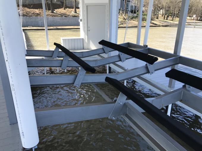

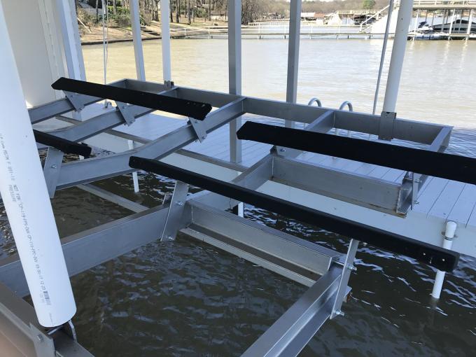

I don't have any measurements but here is my new cradle and lift after i purchased my G23
Originally posted by GMLIII View PostHere is my lift set up after it was reworked for my G23. I added a new cradle, cables , pillow stack bearings, steel cross beams. To note, I went from 2 bearings to 3 bearings on the pipe and chose the pillow stack design bearings which cost a little more, but they were well worth the investment. The lift is much smoother with 3 bearing vs prior 2 bearings while it lifts the boat. I also chose the double stack stern steel cross beam which helps protect the prop should someone happen to drive the boat too far up on the cradle; the prop clears the steel beam . Not that my lift is any better than other folks, just thought someone may get some design ideas from my pictures.

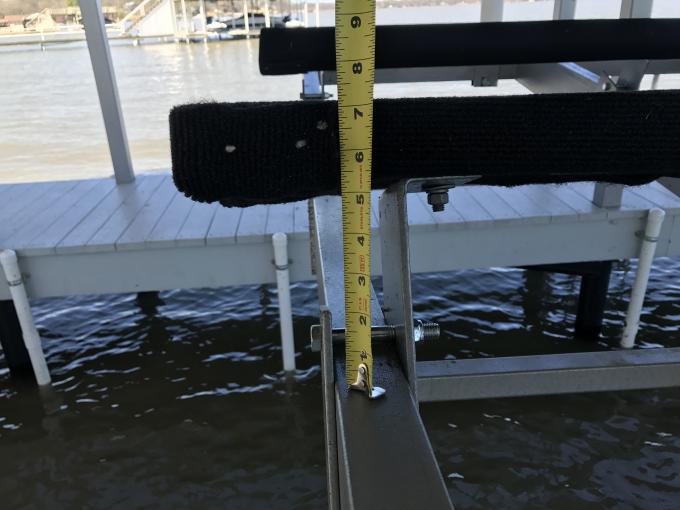

Unfortunately I dont have the heights of the steel cross beam cradle but the height of the wooden bunks are 10 inches (two 2 x 10 boards on each bunk for stability) which leaves enough room for the clearance of the hull tracking fin regardless of where the boat is placed on the cradle. This picture should help you visualize the clearence.Originally posted by Hotsoup View PostHello all - I have a 2018 G23 on order. I need to adjust the bunks or runners on my cradle to hold the boat. I have a picture of a trailer. I was wondering if anyone had any pictures of how their cradle is set up in their boat house. Any pics/advise/measurements would be helpful, thank you!
I would say by eyeballing....that the steel adds about 4-5"....so guess is 14-15" from top of steel to top of bunks clearance. Know the fins are not that deep, but the hull cuts into that some too. You should call dealer and ask him to measure one on showroom floor and then add 25% to give you a cushion, so if 9", do at least 12"
