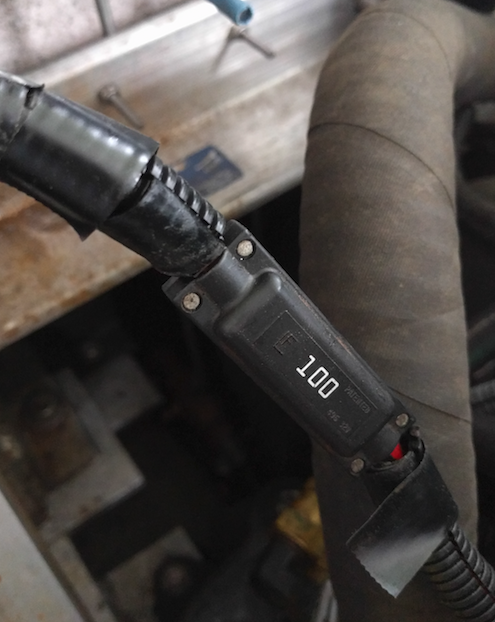

    In this case, the 100 amp fuse running to the starter blew. I suspect that might be the case with mine. I see the little 100 amp case, but there doesn't seem to be a way to open it up to look at or replace the fuse.
    Also, my 60 amp breaker doesn't move. I'm not sure if it hasn't tripped or if it is stuck like some mention in that thread.
    Even if I figure out how to open the 100 amp fuse (or just break the case it to get it out), I don't understand why it would be blown.

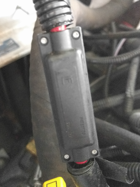

      100 amp fuse case near starter than can't be opened?

        Note that this wire with the 100 amp fuse, and the power from the battery were connected to the same post on the starter. That seemed strange.
          first, put every back to stock spec including the perco switch.
          that breaker is tripped and stuck. had it happen on mine, replace with the correct flush mount and what ever hole arrangement your SAN uses from the factory. some are offset like mine was on the '07 236.
          that black device on the starter wire does look like a fusible link but i don't know how you would replace it and i don't believe its the cause of your issue.
