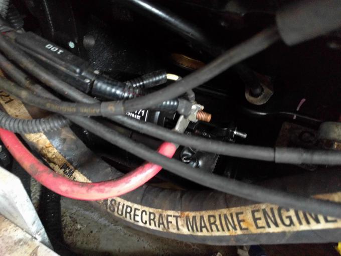

    Here are a few pics. You can see the configuration of the batteries one ground come from the engine bolt on the right side of the pic. Then it is connected to the negative terminal on the other battery on the left of the pic. both positives go to the Perko switch on the left, then from the Perko to the starter. Another pic shows the connection at the starter. What could be wrong? What would explain the symptoms?

      Sounds like some strange problems. I would definitely check your kill switch and your master toggle switch if you have not already. I had some similar sounding issues and the toggle was the issue. Replaced it, and like magic, All my issues went away.

        If you take the switch out of the equation and everything works fine, then it HAS to be the switch. Sounds to me like it's a dud.

            You need to break out the digital volt/ohm meter and do a voltage drop test on the main ground and main positive cables.
