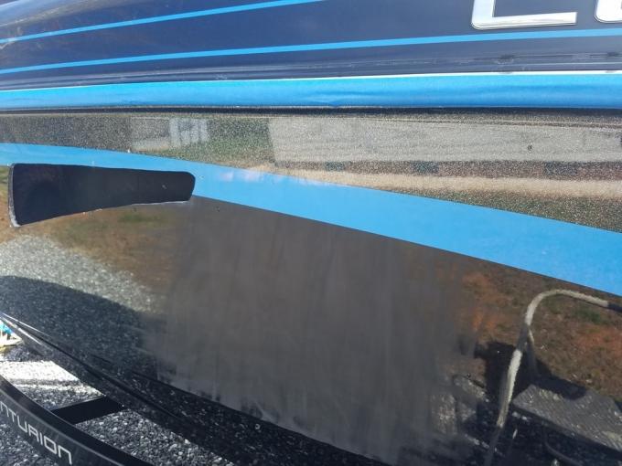

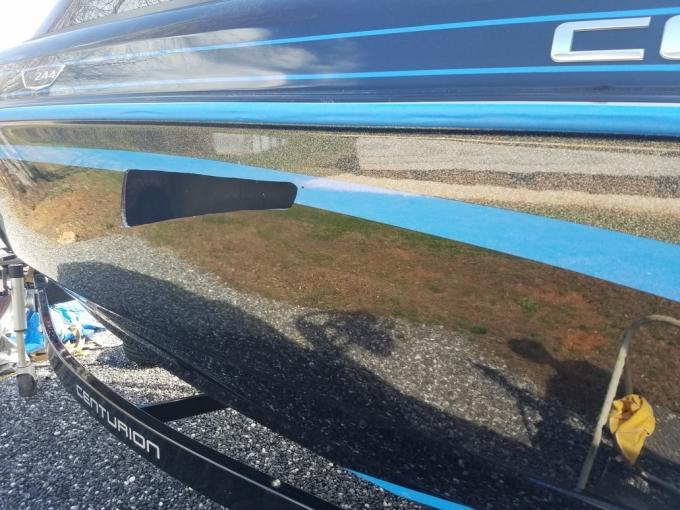

          #34
          Finally worked up the nerve to start sanding boat today. Pretty happy how things are coming. All my light oxidation and water spots come off easily with a few passes of Boat Candy cutting compound.....then I have the Boat Candy Polish and Collinite Wax.
          I have not waxed anything yet, worked for about 4hrs on boat today.....Pic #1 is after I sanded with 2000 grit. It took longerbut i did not want to go with rougher stuff since it already made me nervous, this was the largest spot I had to do so made a good pic. Pic #2 is after 2 times of using the cutting compound. Still some light swirls in it which I hope that the Polish will take out if i work it long enough. Plan to finish tomorrow and then wax the boat. I did not think to take pics of the scratches before sanding, nothing was very deep. My flake was also easy to sand out light scratches and restore

            #35
            Did you sand up and dwn or rt to left....just curious.....or all around?

              #36
              D
              I have rotary variable speed Makita with 9" pads....with wool pad I first spread around on speed #1 going very slow, 2 overlapping passes up and down and 2 passes left to right....then I sped it up to around 1200rpm and did the same....2 overlapping passes up and down and then left to right.
