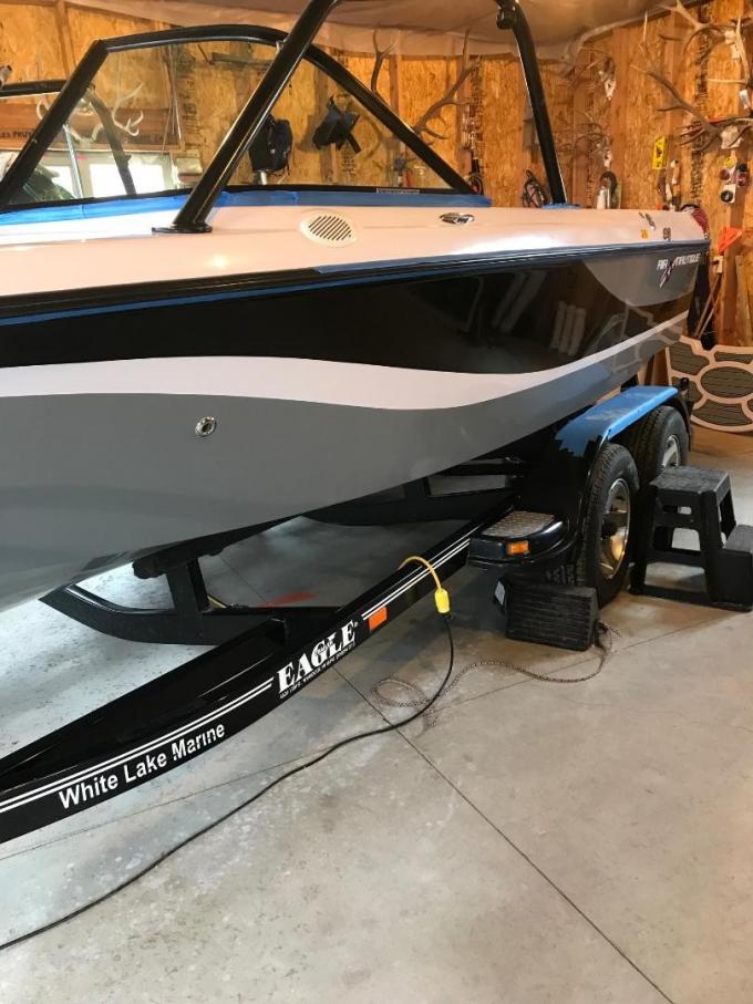

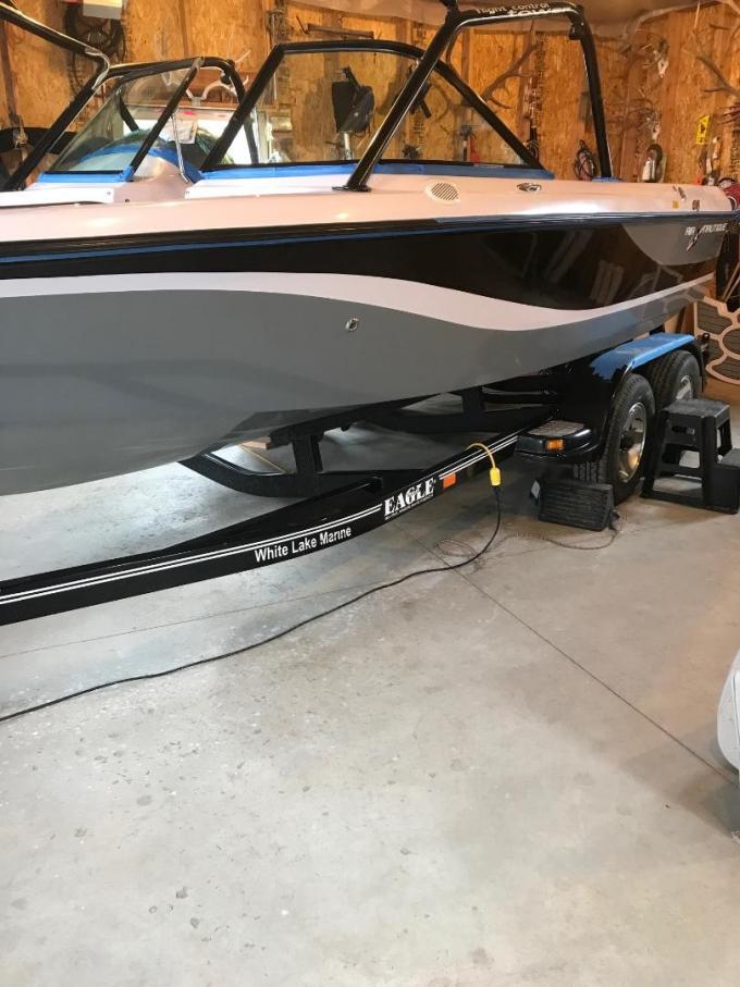

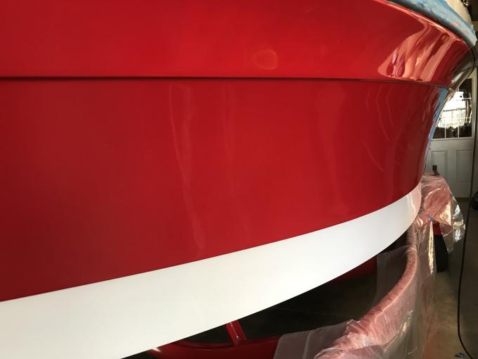

                Sorry just now getting pics, unfortunately don't have really any good before/afters but it does shine now. Click image for larger version
ID:	550012Click image for larger version
ID:	550013Click image for larger version

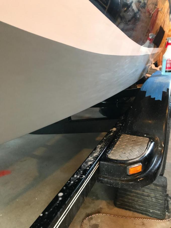

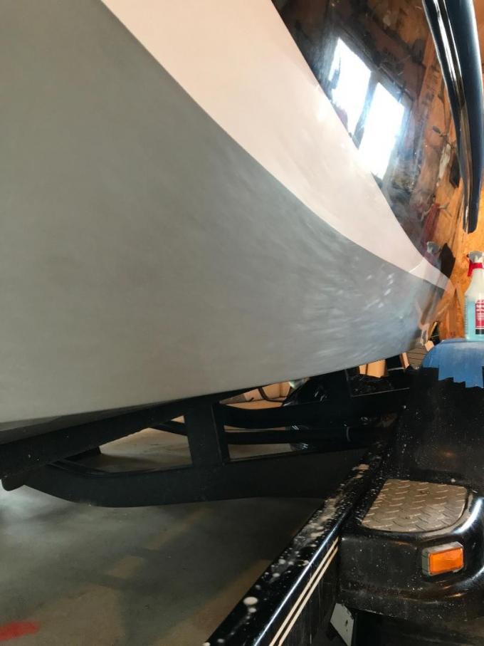

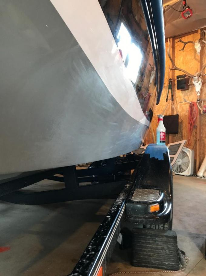

                          WHOLY COW! PUMPED!............thats all I can say Sanded half the boat yesterday.......focused on the grey and white (black is in good shape) This is a process I would say. In fact.....debating other side. So I started with 1500........seemed to do fine until I wiped it down thoroughly and let it air dry. I noticed there was still oxidation showing through in areas......decided to do 1000. That helped and made a uniform area of marks. Went back again with 2000.
                          • Rockymtnsurfer
                            • Nov 2017
                            • 404
                            • Steamboat Springs Colorado
                            • 2003 210 SANTE
                            #28
                            Used 3m heavy duty compound last night on half side..........and then 3m finesse on top of that half. I have to say.......maybe I am not even close to being done........but its not looking as nice as before I started (even though I knew the oxi was there) little worried.....so I quite and went to bed! I am going to re-evaluate it today in natural light. Thoughts from anybody......I did try a little marine 31 polish wax on a area to see how much better.....not impressed. I have a feeling more elbow grease is required. USING: foam disc system .......3 step......also tried with straight wool. orbital porter cable

                                Thanks Blamey.......using 3m system pads....(First Round) red heavy first with super compound......then went to black finish....with finesse. did 1000 1500 in most spots..then 2000. Using wool as my finish clean polish pad 3m.
                                (Second Round) Just got done doing the whole side again.......I have to say I am way more satisfied today. I don't think I used the heavy compound correctly yesterday or long enough....or enough product. Either way, I switch to the yellow medium pad and used a little more product, glasses!, and rubbed it in smaller areas for a longer period of time. Then came back and did the whole side with the finesse and black finish foam pad. Then wool over the whole coat. Came out a TON better....still see some scratches at certain angles.
                                QUESTION:
                                If this is done correctly.....should it look like a brand new coat of paint and clear coat with no scratches, swirls etc. at all?.....just solid color?
                                I feel for people who have done this before. More annoying on the body than the actual patience of the project. A small stool with wheels would be great!
