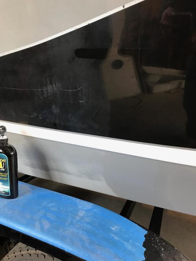

    I thought I would ask around before I go through a second work out on polishing this boat up. Thoughts?
    Before Pics: (I thought this would be better for opinions)

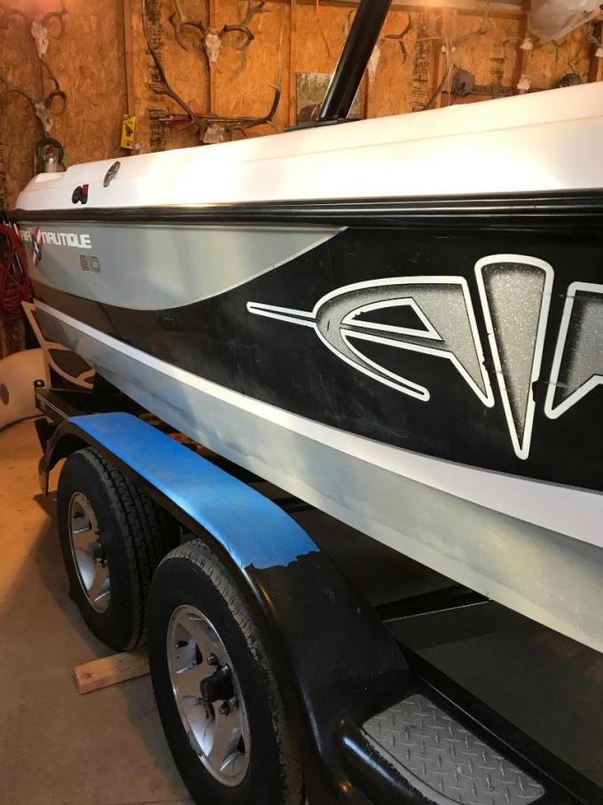

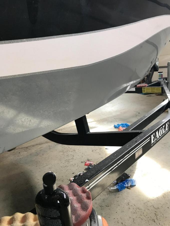

    Marin 31 Heavy Oxidation removal.........and heavy med and light pad system used. Finished with wool polish
    This is the first half:

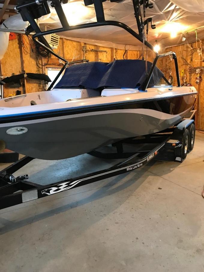

      Finished look.......looks nice and shiny!

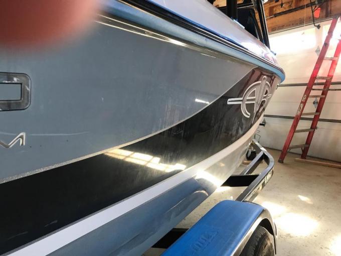

        This is the problem......when I get in certain lights and certain angles.......I still see the water marks.......I can also see staining still as well. From afar this boat looks nice....even up close it looks nice, but these certain angles are driving me nuts!
        My plan was to do the whole thing again...same process.....I was going to test a spot and see if more comes off today......but i thought I would see if anyone has been here before.
        If it is what it is! this will save me time
        Thanks

          I’m going through the same thing with my 206. Boat looks great but in certain lights I can see oxidation. I buffed it with 3m super duty but it wasn’t good enough for me so now I’m wet sanding starting with 1000 grit. Working my way up to 2000 grit. Then I will buff it out after I’m done.

            If you really can't live with it then wet sanding is the next step. The oxidation has gone deep and your just going to have to bring the surface down to make it go away. I would be VERY conservative follow in the footsteps of hyperlitep Go with 1000 grit wet follow by 2000 grit and then buff. My only experience with this was on an old 1987 Ebbtide I owned years ago and wasn't too concerned about screwing something up. I would be sweating on my Nautique so you may want to consult some others before thinning out that gelcoat too much. I believe 1000 grit is appropriate here but I am by no means an expert.

              I thought I would just add something else as I've seen this before. When you are buffing heavy in a certain spot, you can cause more material to be removed in one spot over the other. Especially with some of these heavy oxidation removers. This can cause some unintended swirling effects. It isn't that easy to do but it can happen. It doesn't sound like this is your issue but I thought I would mention it for completeness.
              If you wet sand, wrap the paper around a block so you level the area out. Because of the boat contours, you'll probably need something a bit stiff but flexible as opposed to just a block of wood. I'm thinking like a soft wood like in an old yard stick or something. This unevenness can play with the light as well and cause issues. You might just get some 2000 grit, wrap it around a block and go over the area to see what happens.

                You really need to look at your compounds, as an example 3M super duty is about a 1400 grit so going beyond 1200 is not doing you any good. For the OP, not sure about the products you are using, my recommendation that is a proven winner is after wetsand (if req'd) 3M super duty compound - 3M Finnese it - 3M Perfect it - Collinite Wax
