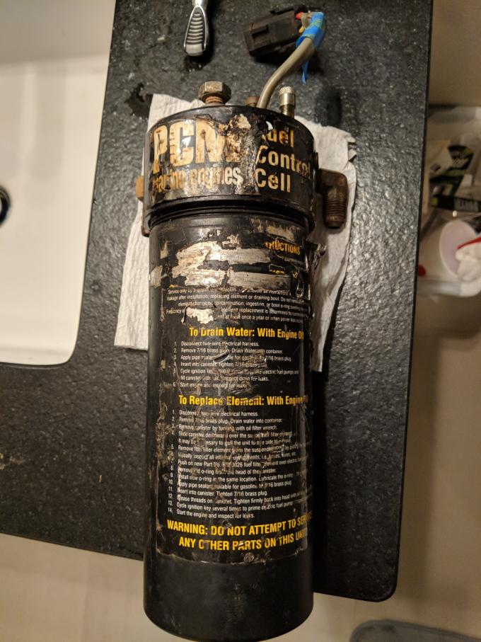

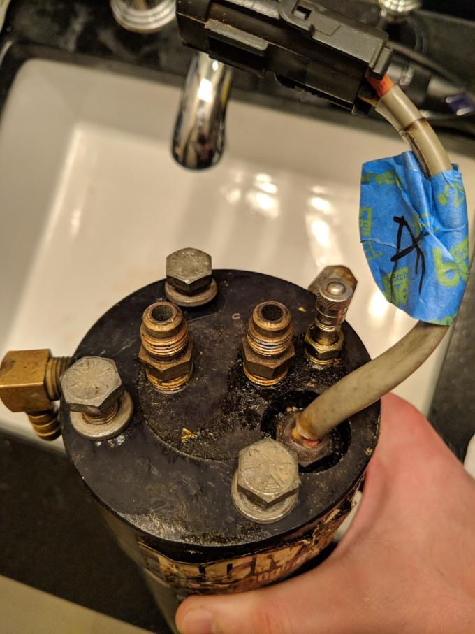

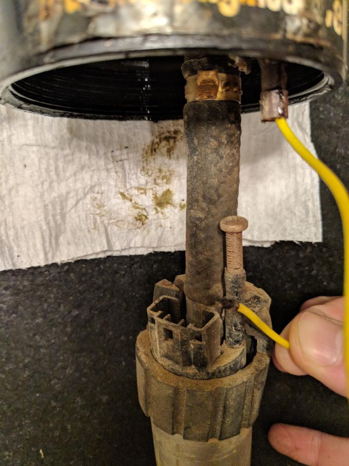

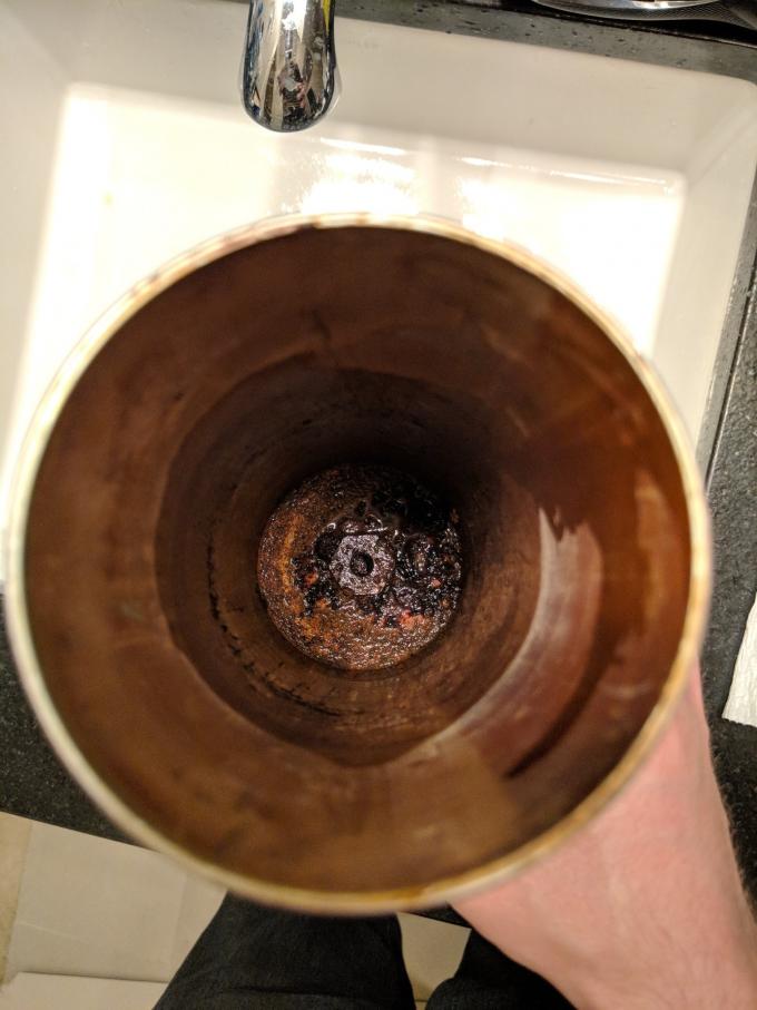

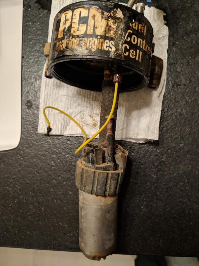

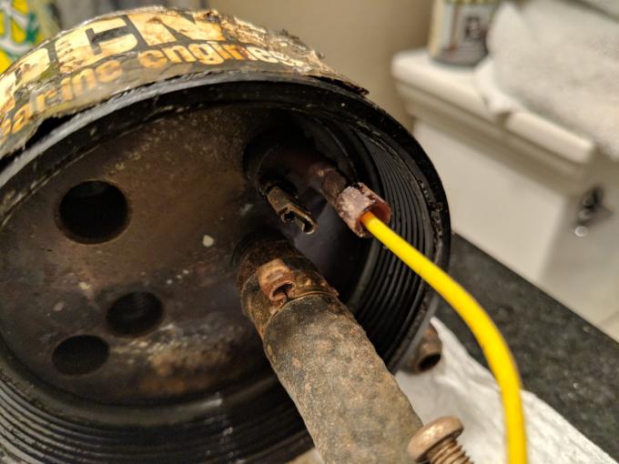

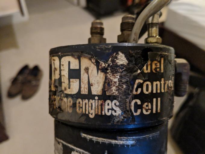

    3. High Pressure Pump - When I opened the Fuel Control Cell which has the pump in it, I found a mess. No filter, and the power cable was missing a lead (pics attached). So I believe I have 2 options.

          that looks like a whole lot of mess right there! To much crud to be an effective fuel delivery platform. I would rebuild from the bottom up that fuel system then see if you have any electrical circuit issues.

            What is the tank like? If you have all that varnish in the fuel pump I would evaluate everything upstream too.
            Well the injectors are probably plugged too. I’d expect the whole system to need cleaning and or restoration.

                  Yea, lot of varnish, looks like they left ethenol fuel sitting untreated for a long time, replacement of FCC seems like he only way to go, good call. I would check inside of fuel lines too to make sure they are not deteriorated. I had a 2006 a few years ago that I replaced all the fuel hoses cause previous owner had let it sit in driveway for 2 years and they looked pretty bad.
