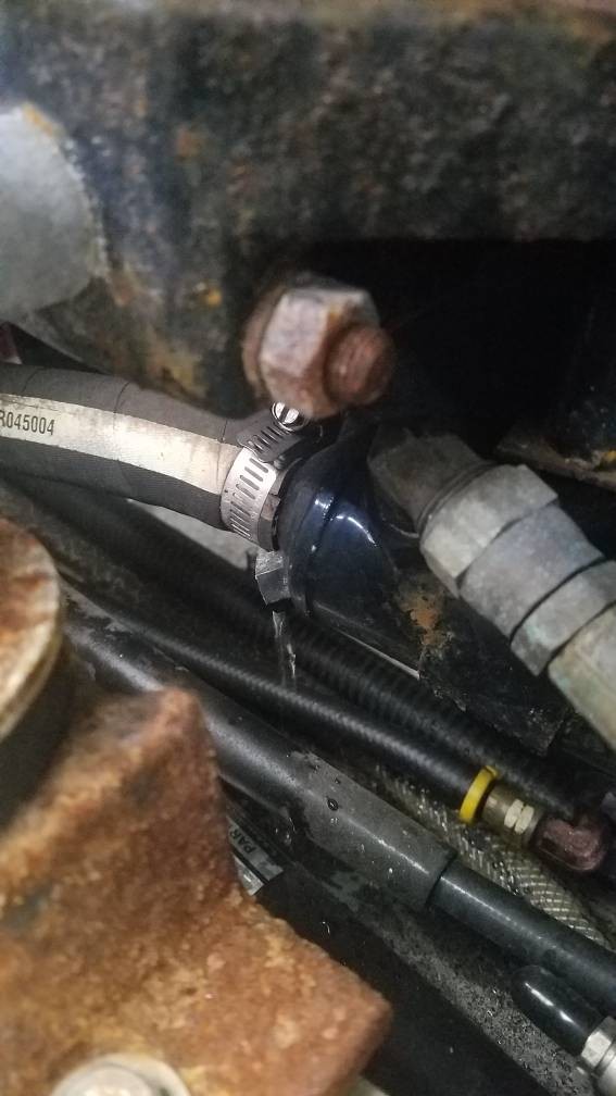

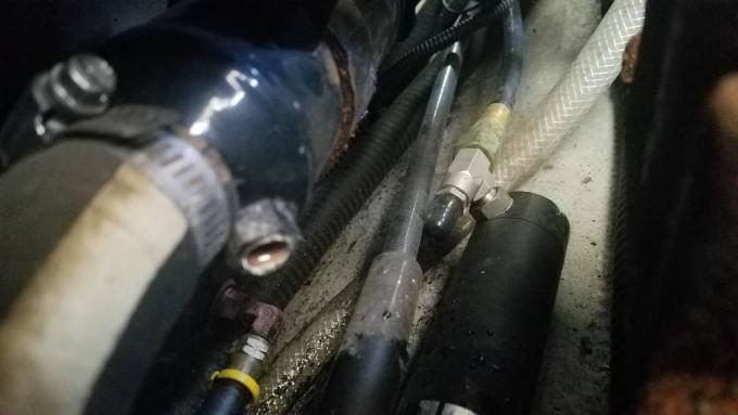

    I found this little port on the trans cooler
    Sent from my SM-G930V using PLT Nautique mobile app
    • teamseal
      • Dec 2006
      • 416
      • Panama city, Florida.
      • 2008 196, 1992 Shamrock 20' center console, 1965 Rickshaw race boat, 2017 ski 200 H6.
      No that little fitting is for draining your transmission cooler. you hook up to that and it will suck air rather then push water. we normally "T" into one of the 1" hoses going to the exhaust manifold from the thermostat housing for water supply to the dripless seal. a quality XPC Seal kit would have come with that "T".

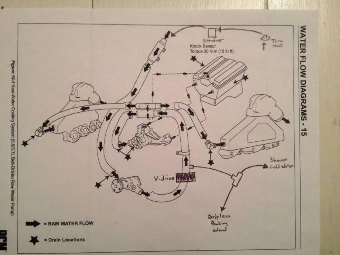

          I found this. I see what you're saying. That spot is on the suction side. So you're recommending something like this guy has sketched

                If that is what your dealer Mechanic is telling you then you might want to find another mechanic! The drawing above is correct. water supply to a dripless seal needs to come from the pressure side of the raw water cooling system. a good stocked Low's or Home depot will have brass fittings that can be utilized. I prefer to take the water coming off the thermostate housing over the hose right out of the raw water pump. have actually seen instances where the hose was blown off from the direct pump pressure.
