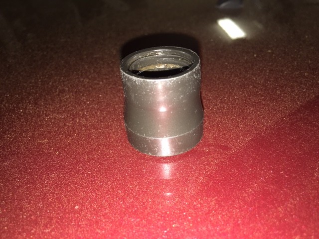

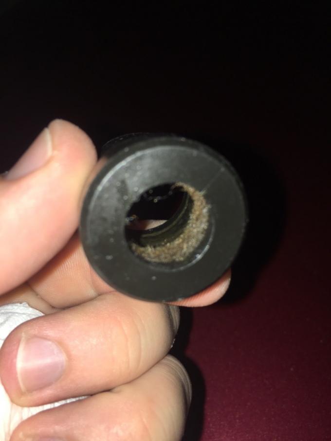

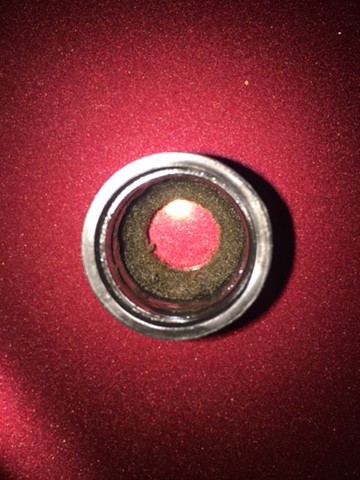

    3 weeks and 7 hours of use into owning 2006 nautique sv-211 puchased from a dealer. I found this black plastic piece in my bilge space near the plug after a day of use. im not sure if this has been in there the entire time i have owned the boat but it surfaced after having some stalling issues on the last outing. does any anyone recognize what this is? first inboard ski boat i have ever owned. thanks Click image for larger version

    the end of a steering cable? curious find

      Steering cable seal,goes on the end of the support tube near rudder connection

        Thank guys looks to be spot on .. dealer changed steering cable before purchase last month. Gives me some peace of mind now hoping the stalling was only from weeds in the strainer. Boat had full service 7 hours ago

            Steering cable has been replaced and that is a remnant part of the old cable, grease seal.
